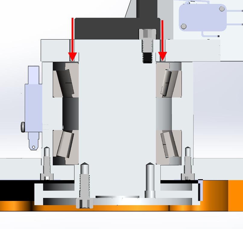

                        <description><![CDATA[@danielgigliotti99-dggmail-com I would use PETG but it should work fine - its not that much pressure to preload.]]></description>
                        <content:encoded><![CDATA[@danielgigliotti99-dggmail-com I would use PETG but it should work fine - its not that much pressure to preload.]]></content:encoded>

                        <description><![CDATA[@chris-annin Ok got it, thanks. This is very nice. Just out of curiosity, if I were to do something like this with a different material, for example PLA + heat set inserts, it wouldn&#039;t work ...]]></description>
                        <content:encoded><![CDATA[@chris-annin Ok got it, thanks. This is very nice. Just out of curiosity, if I were to do something like this with a different material, for example PLA + heat set inserts, it wouldn't work because the tension of the screws will deform the plastic rather than preload the bearing, right?]]></content:encoded>

                        <description><![CDATA[@danielgigliotti99-dggmail-com no the screws place direct pressure on the bearing center housing and preload the bearings.  Im attaching a section view.
&nbsp;preload.jpg]]></description>

                        <description><![CDATA[@chris-annin So there is a small gap between the two components and tightening the screws brings them closer?]]></description>
                        <content:encoded><![CDATA[@chris-annin So there is a small gap between the two components and <span>tightening </span>the screws brings them closer?]]></content:encoded>
