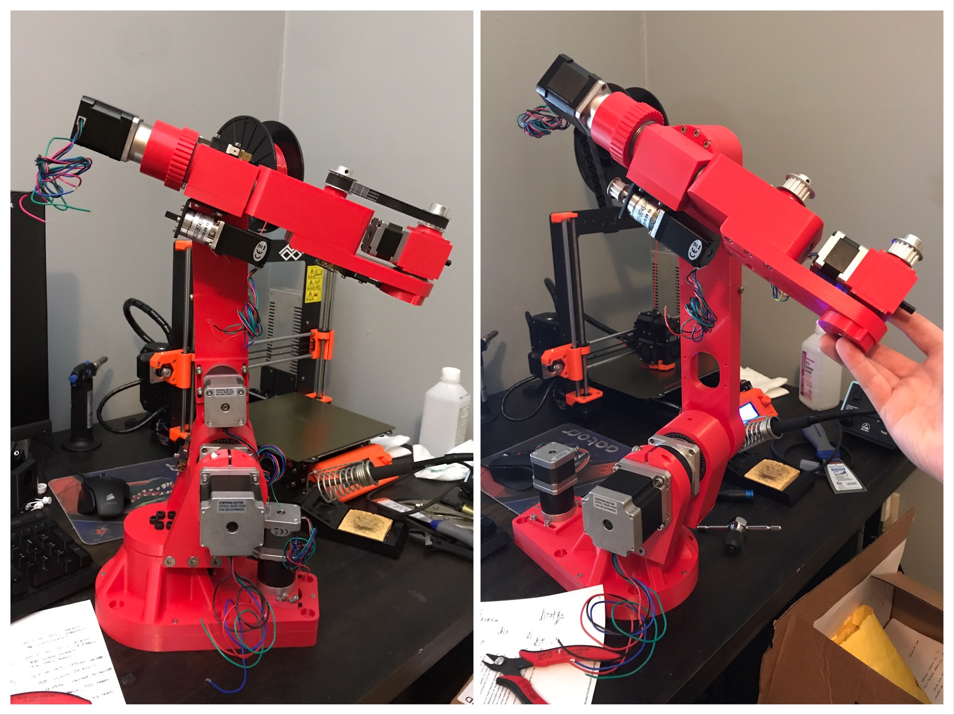

The photo on the left shows the robot rotated 180deg on the base (for storage). The right shows the robot in a partially assembled state.
I purchased the CAD (SolidWorks) files from Chris’s website so I could make some design modifications and then 3D print. I wanted to be able to export high-res STLs, so curved surfaces were curved rather than triangulated. I printed everything on my Prusa i3 MK3 (8” square build surface) with IC3D Red PET-G. All in, not considering reprinting any parts, it was just north of 70 hours of print time and under 2kg of filament.
Maybe the most visible design modification is at the base. I integrated the base and the J1 Turret, as well as the support ribs. This took the longest to print, at around 15 hours.
Due to the build surface constraint, I had to cut the J2 arm in half. For increased rigidity, I made the walls taller, similar to the supports Chris recommends when printing. I made some overlaps and printed a separate, bolt-on stringer to tie them together. It’s still a little wobbly, so I may revisit the design.
The modification with maybe the most design work is with the J5 actuation. I changed from the lead-screw-driven system to a bevel-gear-driven system. Initial (no load) testing shows pretty good prospect. By tensioning the belt, the J5 extended arm is slightly bent (it’s plastic...), so I may revisit this and go to a more direct-drive system. But for now I’m happy with how it’s working.
By changing to the bevel gear drive, I used a geared stepper, which sticks out the back of the J4 arm further. To utilize this space, I incorporated the J4 hub into the J5 motor mount.
For the J5 drive pivot on the J6 assembly, I had a hard time getting enough torque on the J5 drive pulley set screw without cracking the plastic. I modified the whole J6 design for ease of printing (modular instead of all-in-one) and used the leftover 8mm keyed shaft from J3 to fix the pulley. So far so good!

Nice work. Its awesome to see what you have done. Thanks for posting this. Please keep us updated on your progress. I’ve had a number of people asking about adapting the software for raspberry pi - if you could post a how to, a lot of people would be very interested. Thanks again.
Paul McLaughlin
(@paul)
Joined: 11 months ago
Posts: 37
Nice work!

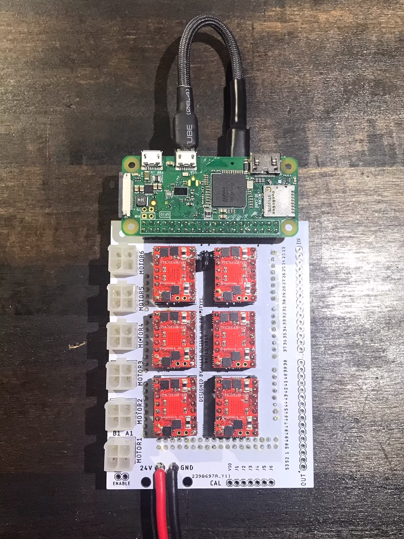

I got the boards in yesterday and started assembling them tonight. There are some tight fits, which I’ll address in the next version. All of the drivers are mounted, the 2 buck converters are on the back (nested between the board and the Arduino), and I made a custom USB-B to micro-USB cable to jump between the Pi and the Arduino. I‘ll have to finish assembly and then test it out another day. Stay tuned!

While I’m still in the process of developing the ShushEngine, I’ve got a revised driver board/Arduino shield I want to try out. This picture is pretty low-res, but maybe you’ll be able to pick up on a couple things.
It uses the TMC5160 SilentStepStick breakout boards, which still uses Step/Dir. So it should still work with Chris’s original software! Next, I’ve got a jumper toward the top of the board, which allows you to pick “MEGA” or “DUE”. That’s right, I’m going to try to make it work with the DUE. I’m not 100% sure it'll work, because I’ve never used a DUE, but I’ll give it a shot. The jumper basically selects between 3.3V and 5V logic. The TMC5160s can work with either. And the board keeps the 3”x100mm size from the last version (not sure why I mixed units on it, but whatever). I’ll keep everyone posted on how this works. If it does, it’ll save a TON of space.

Wow, so nice. The RPi + Arduino looks like a great combination. I'm thinking of a carrier board too (just posted in my build) but this is clearly a good way to go.
Did you have to do lots of filtering on your buck converters? I'm always a little leary of powering stuff off the same supply as the steppers (I've fought with this on my home CNC machine), finally ended up with a separate logic supply. The AR2 has much smaller steppers, perhaps there is less to worry about.
You got me thinking; I should consider putting a RPi on my carrier too 🙂

Wow, you're doing a huge job.
My English is not very good, there are things that I have not understood well. With your Shusengine, what do you do is load the arduino control into a RPi? Do you eliminate arduino from the control part, as well as the drivers that Chriss uses in your project, no? I was talking to him about the possibility of using Arduino Due 32 bits and tmc drivers like those used in 3d printers. With the Shusengine theme, when loading the control in the RPi, would you also load the Chris control software for PC in the same RPi or should you continue using a PC to control the AR2?
I'm waiting to start the construction of AR2 printed on PET-G too, you had to give horizontal expansion (I use CURA) to improve the tolerances of the bearings? Greetings and great work! I look forward to your progress.

I'm working on making a driver system similar to the SlushEngine, but with TMC5160 drivers by Trinamic. They offer a lot of impressive functionality, but I won't go into all of that in this post. They offer a small form-factor, as well as high amp-per phase current. Additionally, they offer 256 microsteps per step, which gives them very smooth and precise operation. One of the best selling points for this application, which the SlushEngine also offers, is direct positioning. As in, the motion controller is built into the chip, and you only have to give it a position command and it does all the hard work internally. That means no step-direction, no Arduino required, and no real-time OS (e.g. RPi Raspbian OS).
I've modified the SlushEngine project for the TMC5160s, but it's very much a work in progress. It works entirely (and exclusively) on the Raspberry Pi, which aligns with my goal for the project - drive the AR2 with only a Raspberry Pi, preferably the $5 RPi Zero W. My milestone tonight was getting the library at a point where a very short Python script would make the motor run 5 rotations (arbitrarily picked) back and forth.
