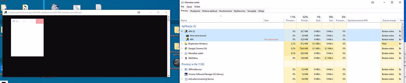

Hey,
I'm just trying to run the program for the AR4 version, but unfortunately nothing happens. The program crashes immediately after starting. I checked this on two different computers. Win10.
Should I install something additional? Python for example?

I cannot run the exe file compiled by you.
Today I compiled the AR4 program myself (also after some problems. With python 3.7 I could not connect the teensy board, after installing python 3.9 connecting worked). and it works.
I tested the AR4 and AR3 program (compiled by you) on 3 different computers.
On one it crashes as shown on the screenshot, on the second only the cmd window appears for about 0.5s and the program shuts down. On the third one it works without any problem.
The AR3 program runs on all of them without any problem.

The downloaded pre-compiled version does the same for me as what is shown in the picture of the first post.
