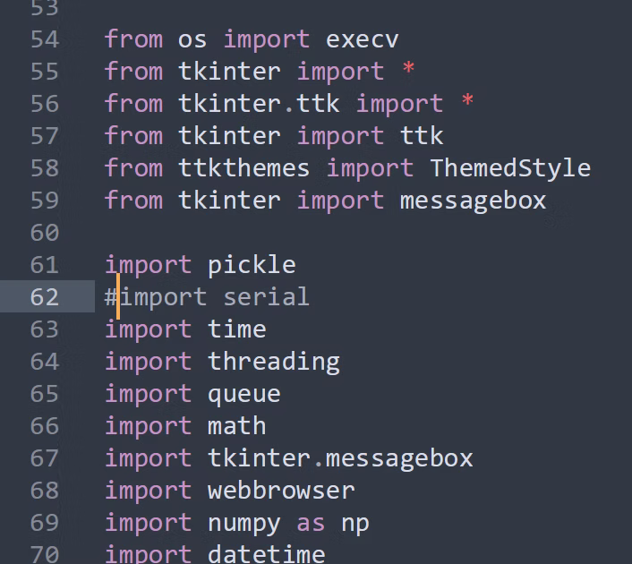

I have spent all day trying to figure this out. I then got a bit desperate and just started commenting out little bits of code to see if something would change.
With serial commented out the software loads right up. I know this isn't a solution but letting you know in case it helps. I'll look in to this further as well.
