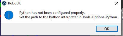

Hi everyone, I'm a student and I try to make a complete project where I need to use the robot AR2.
To generate my code and simulate the robot I use RoboDK but now it's time to send the program to my robot and I can't.
If someone has already done this before, can you contact me to help me please ?

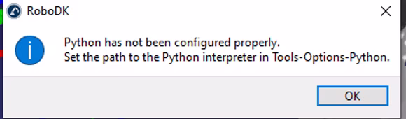

I can't connect my robot to the software, it says :
https://anninrobotics.com/wp-content/uploads/2025/07/connect-robodk-to-AR2.avif
https://anninrobotics.com/wp-content/uploads/2025/07/connect-robodk-to-AR2_2.avif
I'm a beginner in this world so I know I made something wrong but I don't know what ?
Thank you for your help !
Avatar of Dean Bateman
(@dean-bateman)
I'm not sure but you may need to go to the options of RobeDK and set the path of where python is located.
