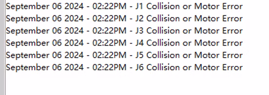

I also tried to run the Home.ar4 file directly without auto-calibration, but the log showed errors for all joints. Do you have any insights on what might be causing this issue?
