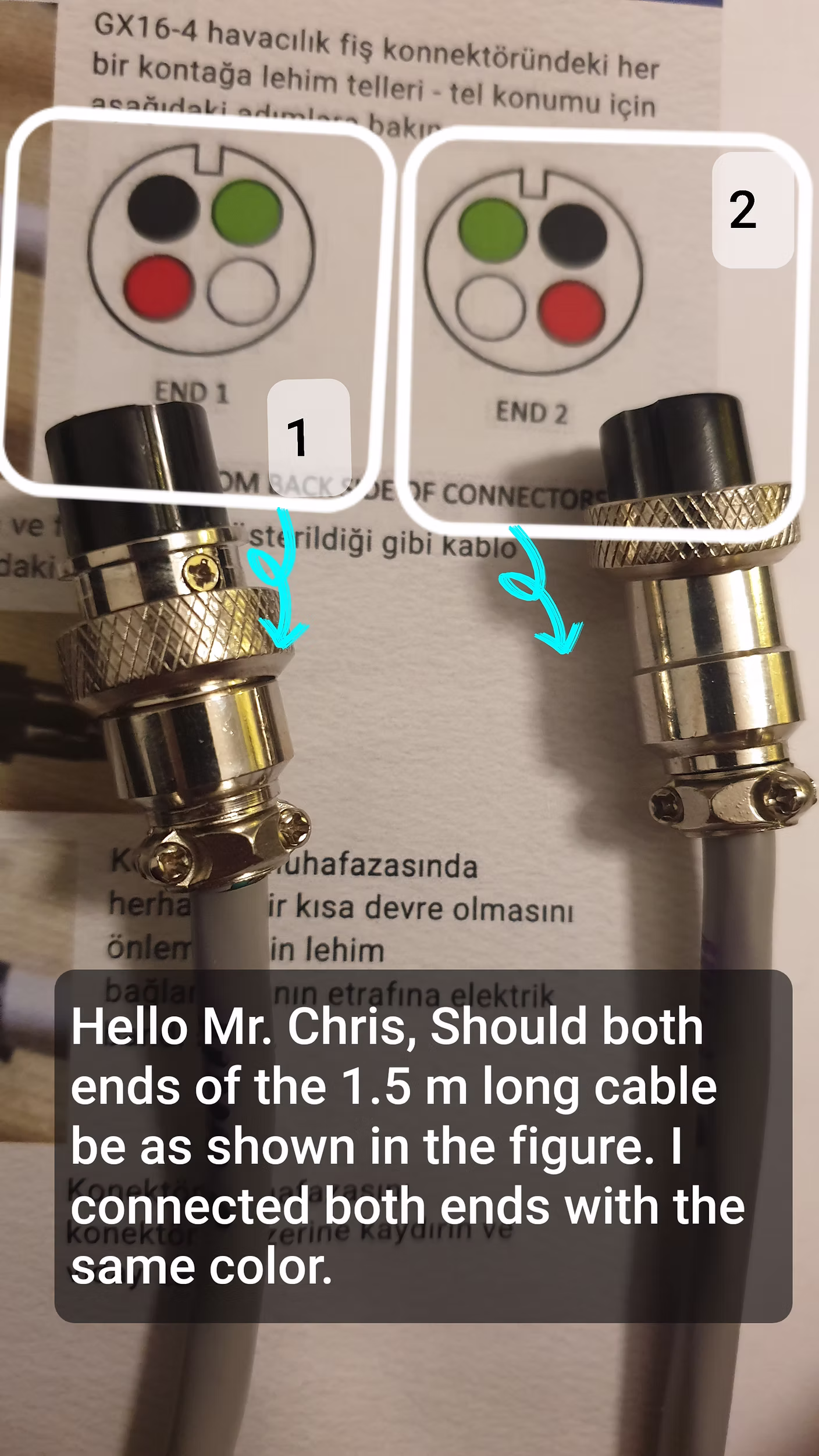

Cable Connection ?
Cable Connection ?

They should be wired "straight through" - each end of the cable will be mirrored, meaning that looking at the soldered side of the connector going clockwise starting at the notch - on end #1 should be green white red black. And then on end 2 should be black red white green. The ends should not be the same.
Avatar of ttrobotics
(@ttrobotics)
Posts: 44
@chris-annin @Chris Annin that is, both ends of the cable consist of the same colors. I'm talking about 1.5 meters of cable. Colors on one end of the End 1 cable and End2 on the other end of the cable? Or did you mean to explain the soldered and numbered parts?
