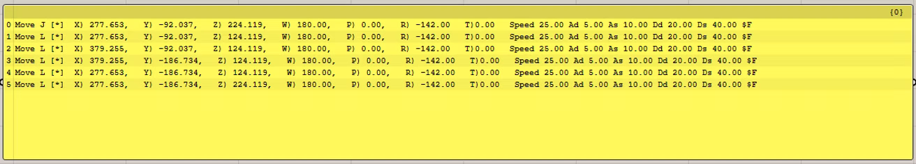

Many thanks for your response, Chris. Maybe I might sound stupid, But I assumed regarding g-code it just has a position and a normal (mainly used for milling or point tools), Will I be able to exploit the XYZWPR of the Robot's 6DOF in a gcode? I was able to create a code generator in grasshopper for Joint and Linear movements in Grasshopper and was also able to export into a file.
But as soon as I using ARC interface and load the program. Everything seems to be deleted. So was wondering if there is a way to upload the generated program directly into your ARC interface either by using load program or something. Please let me know. Thanks.
what is the file type being exported, The programs in my software are a python tkinter list.
Avatar of Pradeep Devadass
(@pradeep-devadass)
I just exported a file from grasshopper with a similar code. Is there a specific tkinter list format? If possible, please can you share a link where I could learn from?
