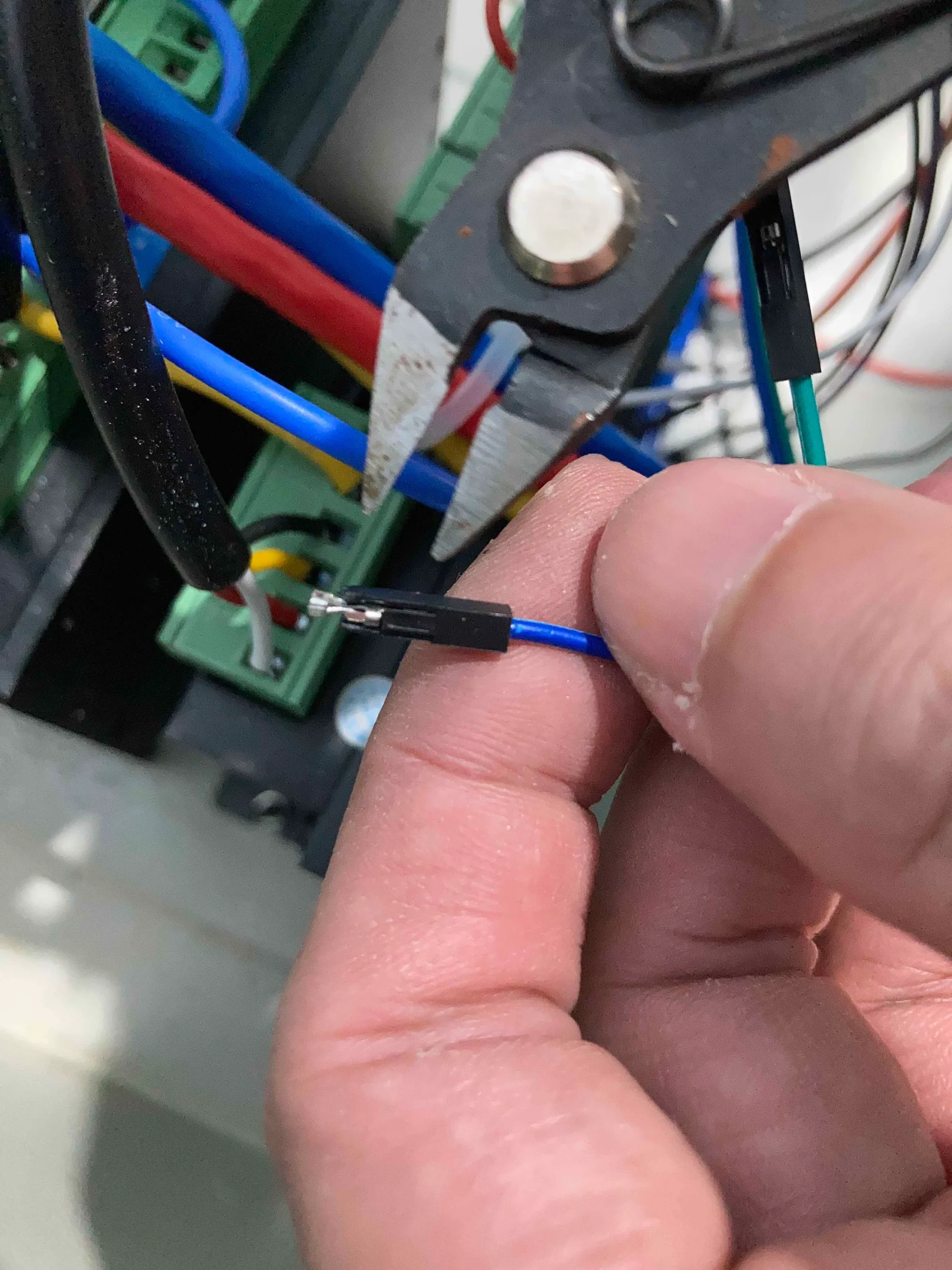

ok u know your encoder not detected, this is only 1 problem. however ARM not move doesn't come from encoder issue. I feel your stepper driver may not receive signal from teensy.
You may try use multi meter test whether both input at stepper driver receive signal from teensy
My way to test as below:
  1. switch multimeter into measure resistor mode
  2. 1 side of multimeter i put at teensy jumping wire there (jumping wire head have 1 small place show metal
  3. another side i put at stepper driver metal screw area (metal too)
You need to test all 6/7 driver

The user manually didn't explain clearly how to put cable into stepper driver. base on picture it simply slot in the jumper cable which is not right. What I did is remove plastic at head side so the stepper driver can lock/touch metal instead of plastic.
