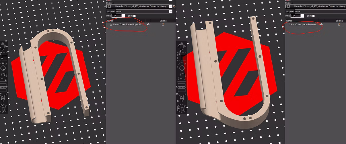

Does anyone have any issue with 3D print the J2 Arm Cover Space Lower? The part/section on the left printed in mid air on my Ender-2 V2 Neo printer. Am I using the correct file? I downloaded from the AR4 Cover Spacers Print Files.
Flip the part on the slicer bro. It's upside-down 🙃

Okay does that mean flipping the part is same thing as printing the J2 Arm Space Upper TWICE?
@david-t-phan Print the lower & upper part with correct orientation on 3D printer bed like this:

Thank you for your help as i am new to the 3D printing. It worked!
