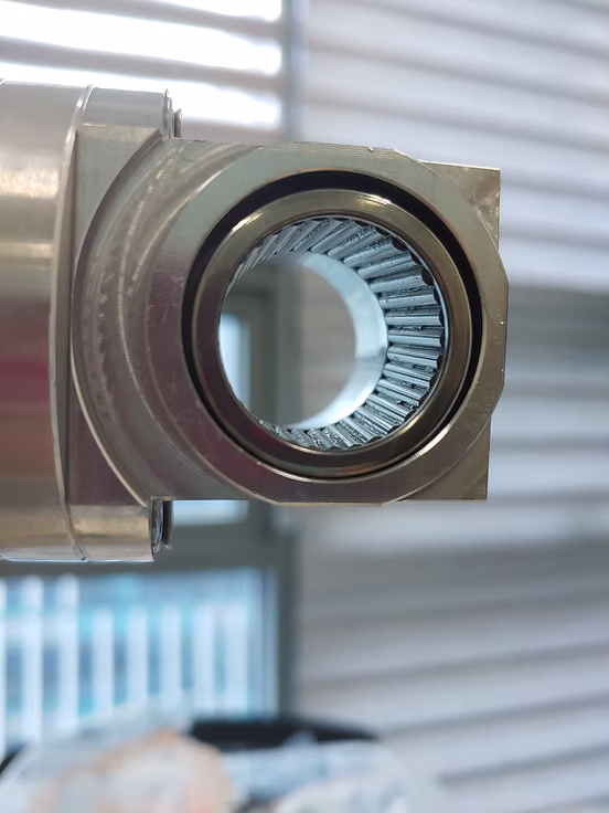

Q1 : J4 turret housing and needle roller bearing assemblying is very loos.
Please check Pic 1. Is this correct?
https://anninrobotics.com/wp-content/uploads/2025/08/J4-turret-housing-and-needle-roller-bearing-assemblying-is-very-loos.avif

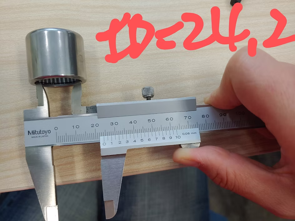

Q2 : J4 main shaft ' OD is 25.4mm and needle roller bearing's ID is 24.5mm. The two cannot be assembled.
In addition, the needle roller bearing OD is 30.25mm.
Different from B1616 (1x1-1/4x1 inch) needle roller bearing OD dimensions.
(Pic 2, Pic 3).
Please check the needle roller bearing we received.
https://anninrobotics.com/wp-content/uploads/2025/08/J4-turret-housing-and-needle-roller-bearing-assemblying-is-very-loos_2.avif
https://anninrobotics.com/wp-content/uploads/2025/08/J4-turret-housing-and-needle-roller-bearing-assemblying-is-very-loos_3.avif

It would appear the bearing cage is was not manufactured correctly. Please email me at info@anninrobotics.com and I'll make sure to get you a replacement bearing.
