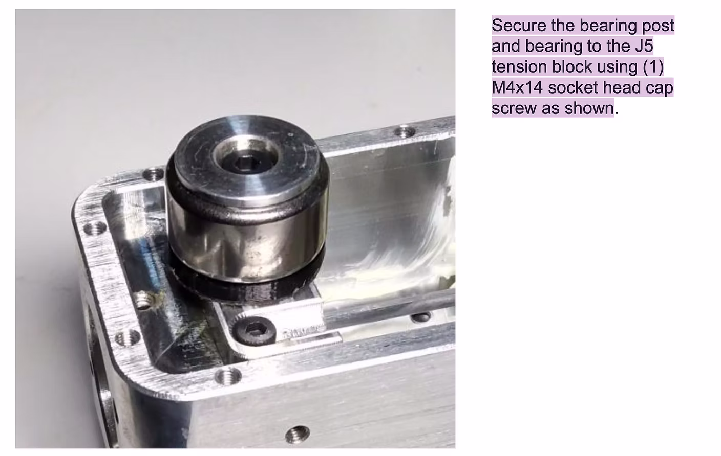

So im confused about the design of the J5 tention bearing. when you "Secure the bearing post and bearing to the J5 tension block using (1) M4x14 socket head cap screw as shown" the bearing can no longer spin. Am I doing something wrong ?

I did put the spacer. When i tighten the bolt even slightly it stops the bearing from being able to rotate

Could it be upside-down?
I finished my build awhile ago, can't remember exactly.

Nope its not upside down. Maybe the bolt just needs to be loose 🤔

Nevermind IT was upside down lol

Actually it was not. turns out my spacer was a little too thick

Mine was too. I had to sand down a layer or so on my print
