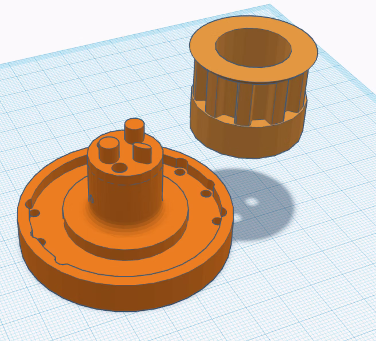

What the hell! 50 euro for it? No way. I had problems with both the j3 bearing-holder and getting those tiny m3 threads properly on the spindle so Im experimenting now with a complete 3D printed, skipping the 6mm shaft all together and with a T10 pulley on the end joined with m4 screws. No idea if its gonna work but.
Avatar of Joop Flack
(@joop-flack)
New Member Customer
Looks interesting but I am not sure if it will handle the force. There are some fibre enforced filiaments which might do the trick.
