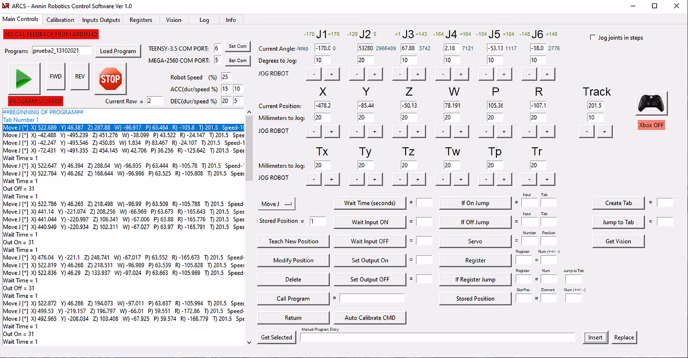

Hi, everyone, My robot has been working without problems, but since yesterday I cannot calibrate and this message appears.
I loaded the program in the teensy again but the problem persists.
I appreciate your help
