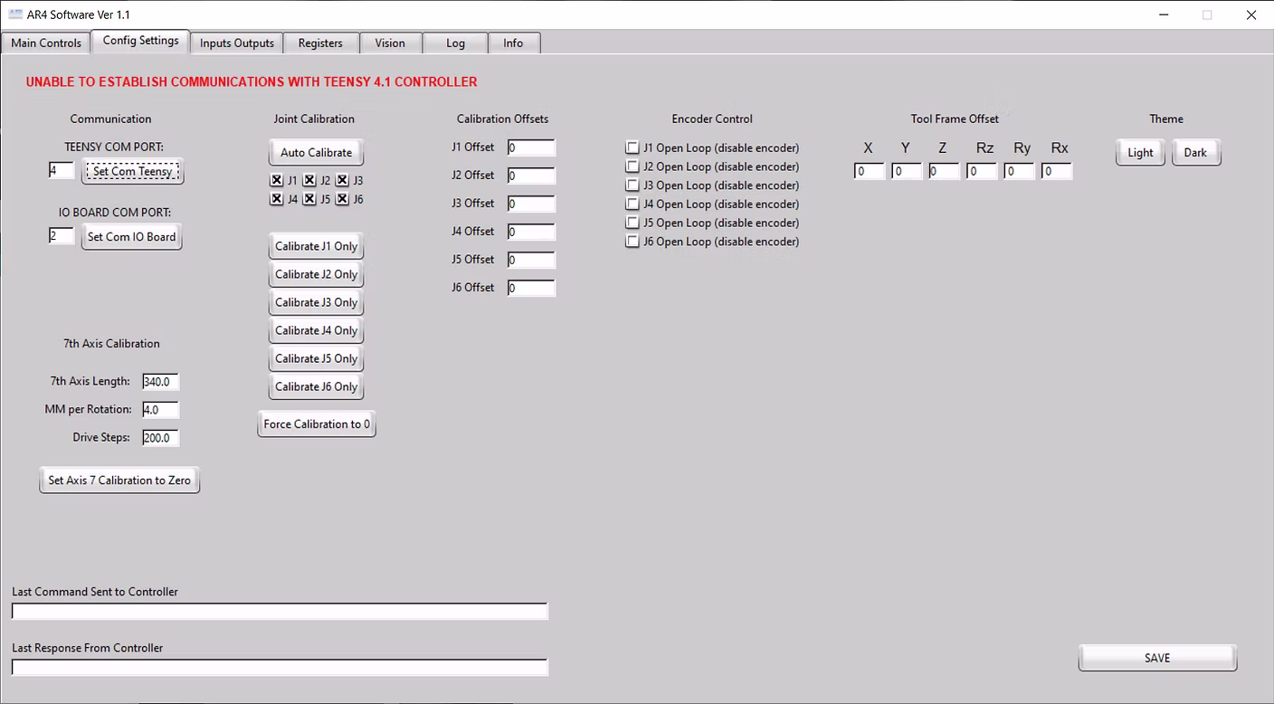

but when i open the python AR4 Software and set the com to: 4 (and click on the button: "Set Com Teensy") it still shows the error message: "unable to establish communications with Teensy 4.1 controller:
https://anninrobotics.com/wp-content/uploads/2025/08/not-able-to-connect-to-teensy-4.1-from-python_2.avif
any suggestions how to debug/check the connection?

minor update: when I try to save the config, i get an error in console:
(ar4-py37) PS C:\........\Annin Robotics\AR4 HMI interface source> python .\AR4.py
Exception in Tkinter callback
Traceback (most recent call last):
File "C:\.....\anaconda3\envs\ar4-py37\lib\tkinter\__init__.py", line 1705, in __call__
return self.func(*args)
File ".\AR4.py", line 4262, in SaveAndApplyCalibration
toolFrame()
File ".\AR4.py", line 4012, in toolFrame
ser.write(command.encode())
NameError: name 'ser' is not defined
note about the windows exe app: when i run the exe version, only a small window starts and the curser spins but the main app is not started.

Hello Simon, the baud rate is set in the app to 9600. my problem with the new app version is that I can not connect to Teensy when I select the correct com port. I still try to understand what the problem is.
somehow i wonder that it looks like that this problem is only on my end. even when i run a vm on win10, i have exactly the same issue.
