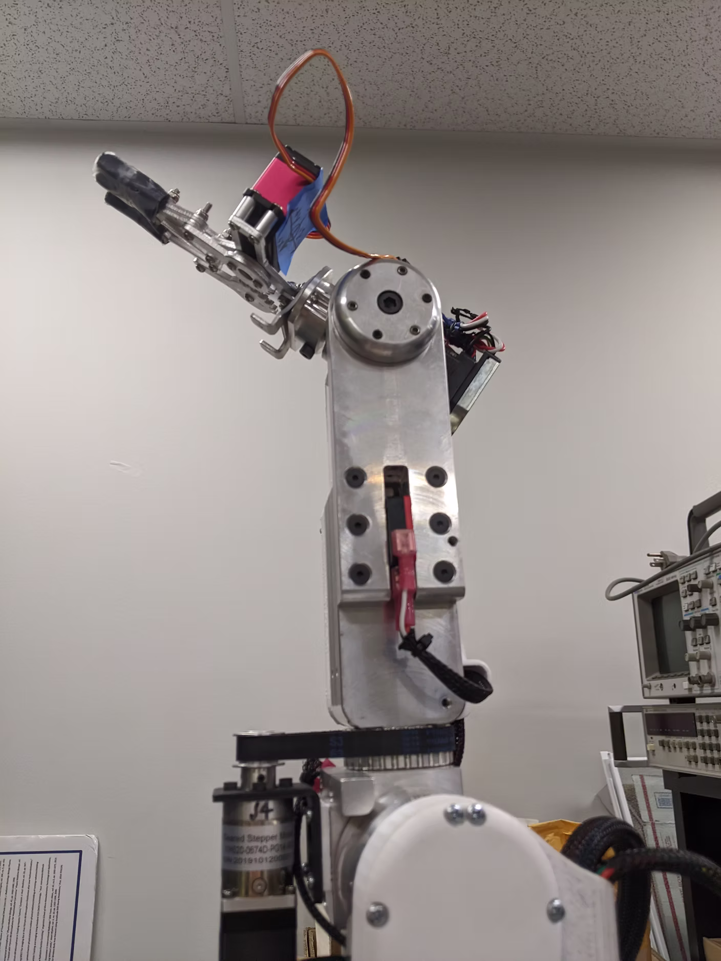

This is the rest position after I did a Z move into my table. How could I recalibrate the J5/J6 back to the vertical rest? Did I break the stepper motors? Thoughts?
Is that position shown after J5 autocalibrates? Is it possible the J6 spindle slipped in the pulley when it crashed - check mechanical calibration where its position is set to 105° when the J5 carrier is all the way forward.
