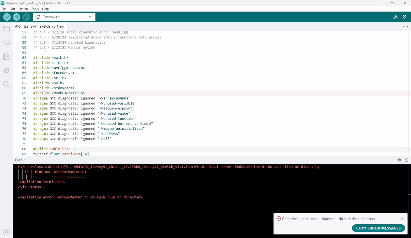

I was trying out version teensy sketch 5.1 and ran into: C:\Users\assis\Desktop\5.1 AR4\AR4_teensy41_sketch_v5.1\AR4_teensy41_sketch_v5.1.ino:69:10: fatal error: ModbusMaster.h: No such file or directory
69 | #include <ModbusMaster.h>
compilation terminated.
exit status 1
Compilation error: ModbusMaster.h: No such file or directory

You first need to install the corresponding library files for your Arduino.
ModbusMaster.h
@goto_2004 is correct. If you navigate to Tools / Manage Libraries and install ModbusMaster you will be able to install the sketch. I have also added details about this in the manual in the Modbus chapter. Let me know if you have any questions.
