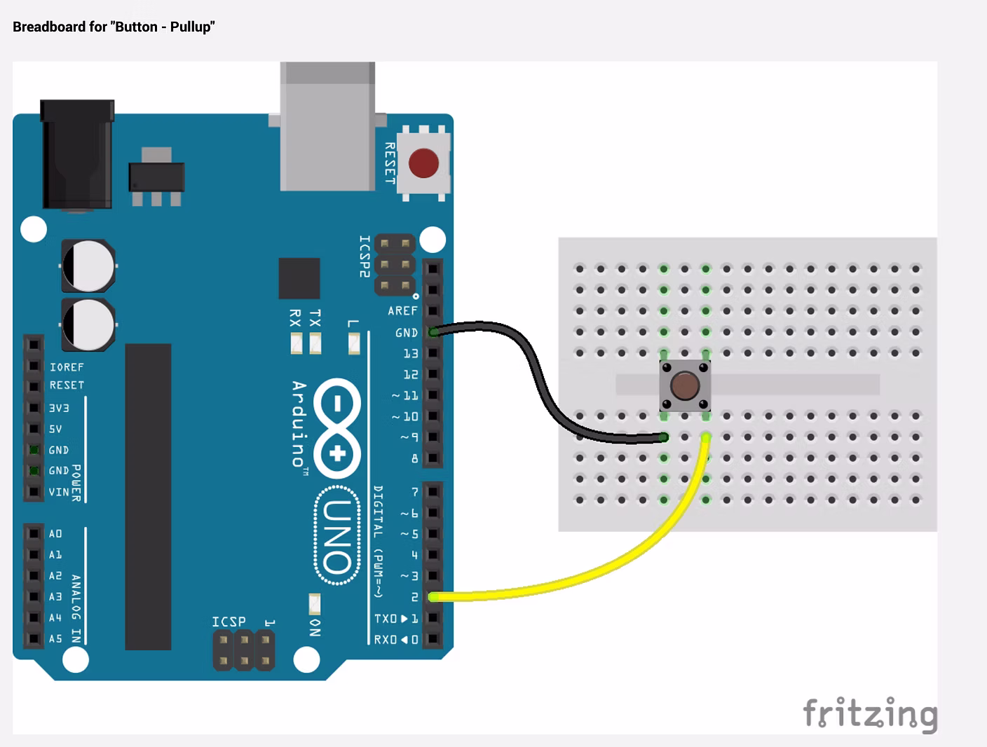

Hi! So It seems each limit switch requires three wires when you can instead achieve the same via the internal pullup resistors in the teensy. See attached image and this link http://johnny-five.io/examples/button-pullup/ Why did you decide to use three wires instead of two ?
The pull-up resistors weren't strong enough to be reliable over a 5 ft ethernet cable, so I opted to do three wires and pull it to ground when the switch is not made. This ended up being the most bulletproof solution that I have found.
