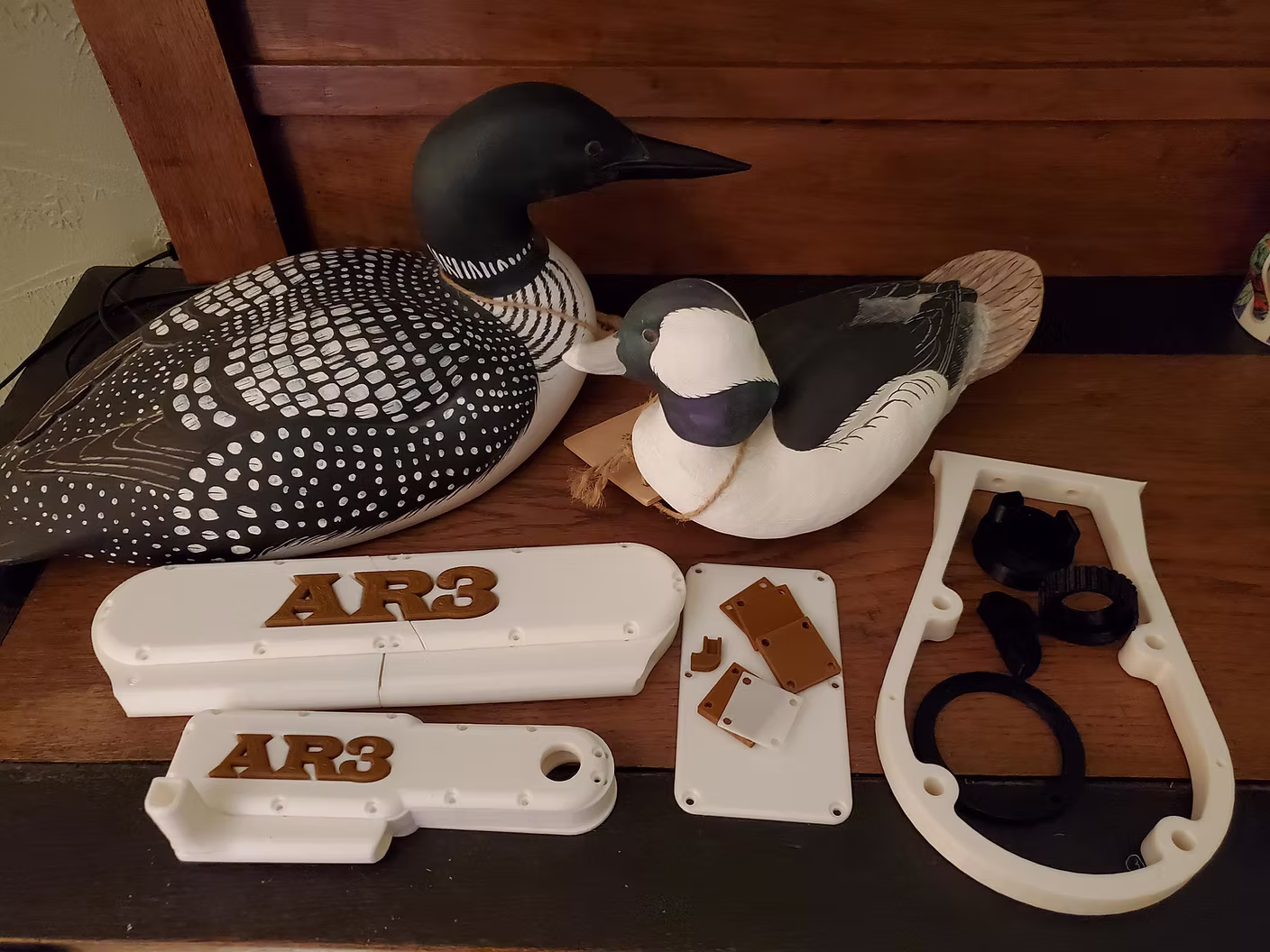

I've started building the AR3 with some of the AR4 changes. I have both the Teensy 3.5 and now a Teensy 4.1. I have a number of encoders so I'm going to do it that way rather than use the StepperOnline motor/encoder pair. Same with a bunch of stepper motor drivers in the parts bin.
I've created Alibre PART files from the drawings which was a really useful way to learn how it was put together. Most of the bearings have arrived from various suppliers. And I'm pretty well done all the 3D printing.
To make the metal parts I'll first make patterns and then cast the rough blanks out of scrap aluminum. Then use my CNC mill and ELS controlled lathe to take them to completion.
Here are the first photos. I have my ducks in a row on the 3D printed parts.

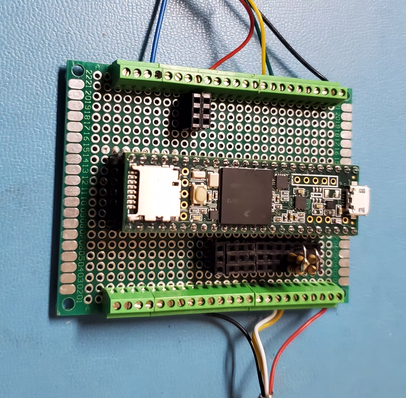

To do this with my interface card I've added some strip sockets where I can insert either the resistor networks or just jumpers to connect directly. The center pin in each row is ground. The one closest to the screw terminal connects to that. The other connects to the Teensy.
https://anninrobotics.com/wp-content/uploads/2025/07/AR3AR4-Build-in-VictoriaBC_4.avif

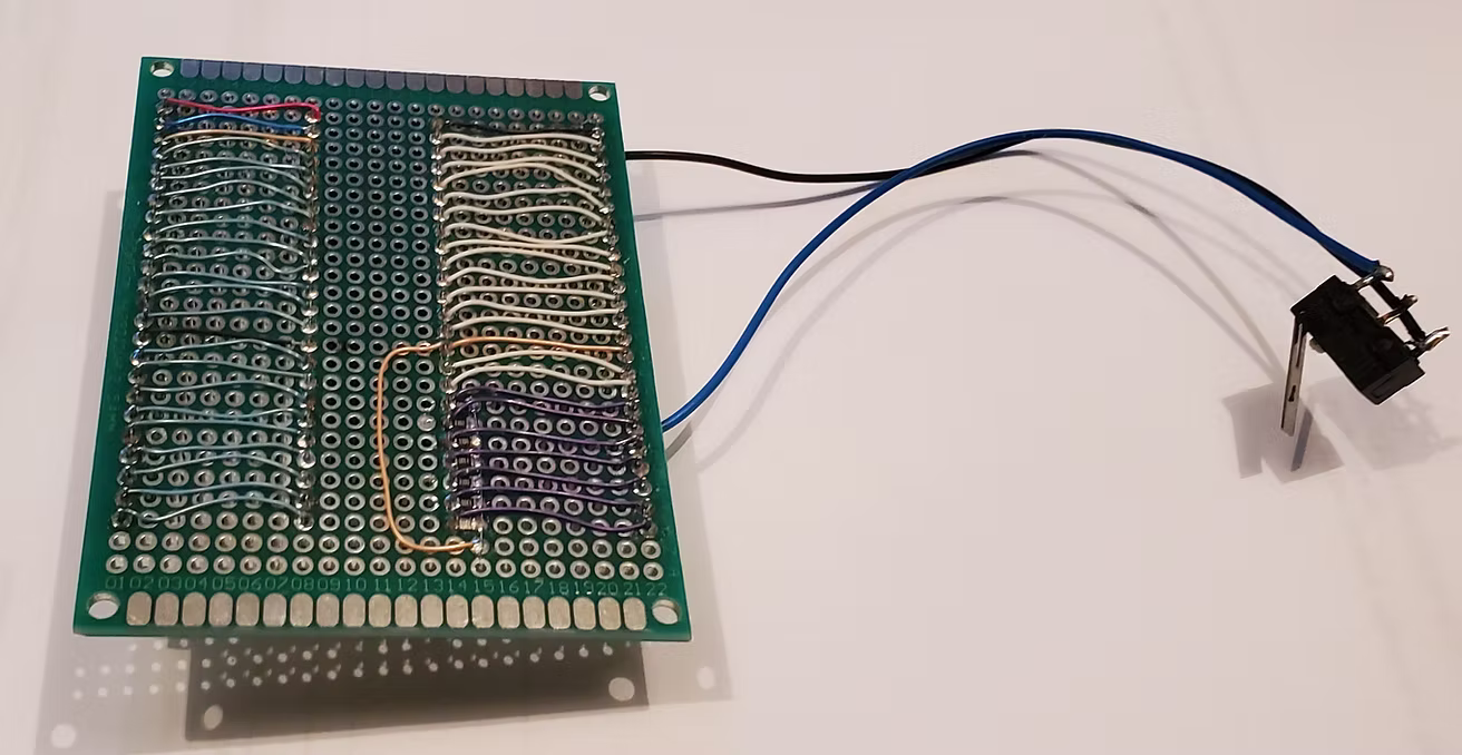

Here's how it's wired on the bottom.
https://anninrobotics.com/wp-content/uploads/2025/07/AR3AR4-Build-in-VictoriaBC_5.avif

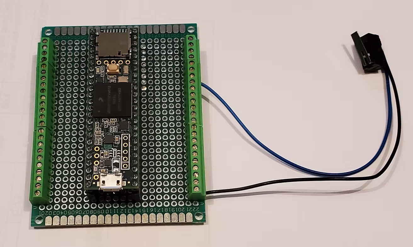

Making some progress inbetween work-work projects. Still haven't gotten around to making the metal parts but since I'm starting out building an AR3 first I thought I'd put the Teensy 3.5 onto a carrier with a terminal strip rather than use the jumper wires.
Also I feel that if I have a 330 Ohm pull up to 3.3V on the carrier then I don' t have to worry about swapping in the Teensy 4.1 and then rewiring to have 3V on the calibration limit switches instead of the 5V. The pull up resistor results in about 10mA current flowing through the NC switch which is halfway between the 4-20ma instrument signals where are quite robust with respect to noise. Once the switch opens or if the wire breaks the signal is pulled to 3V quite hard. They are very tiny smd resistors barely visible in the photounder the violet wires.
https://anninrobotics.com/wp-content/uploads/2025/07/AR3AR4-Build-in-VictoriaBC_6.avif
https://anninrobotics.com/wp-content/uploads/2025/07/AR3AR4-Build-in-VictoriaBC_7.avif
To test the input I wired up one from my junk box. Trouble is the software doesn't have a direct method of testing the inputs so I modified the Teensy 3.5 software with this bit of code and just used the arduino terminal program to talk directly to it.

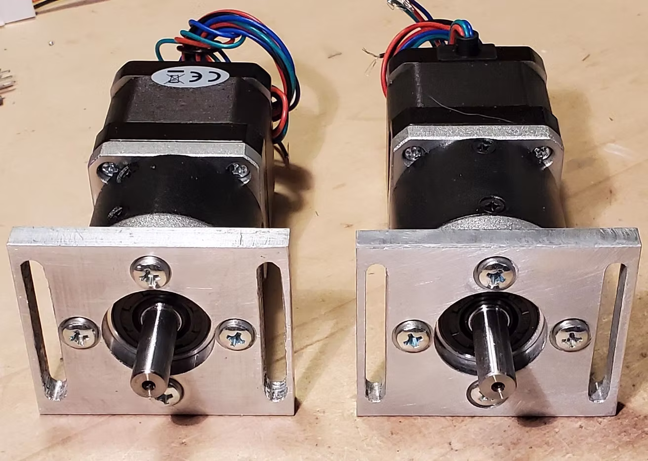

Still need to order 3 encoders. Some of the screws have arrived. The rest are on their way. Started machining some of the parts. Will have to redo these because I put the slot up too high and the first one had way too fast a feed rate. The second came out nicely and since it's all G-Code for my LinuxCNC mill duplicating them, now with the slot in the right place will be easy.
