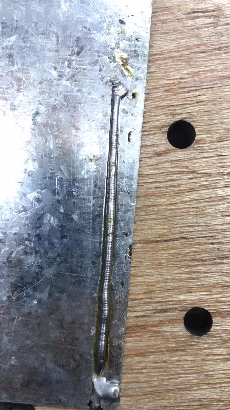

Im developing this project since january, so here are the results.
Here Its the extruder mechanism
I used an MK8 extruder with neumatic coupler, because every jam or material load the TCP move so I use it on the wrist to avoid this.
https://anninrobotics.com/wp-content/uploads/2025/07/AR4-as-a-Soldering-Robot_Video.mp4
So the next step was the parameters for soldering, so on the AR4 HMI I use the TCP lineal speed at 2mm/s and 1arc/s at extruder for the speed so the results were very great
https://anninrobotics.com/wp-content/uploads/2025/07/AR4-as-a-Soldering-Robot_video_2.mp4
A good soldering

Excellent work, looks great. thanks for posting.
