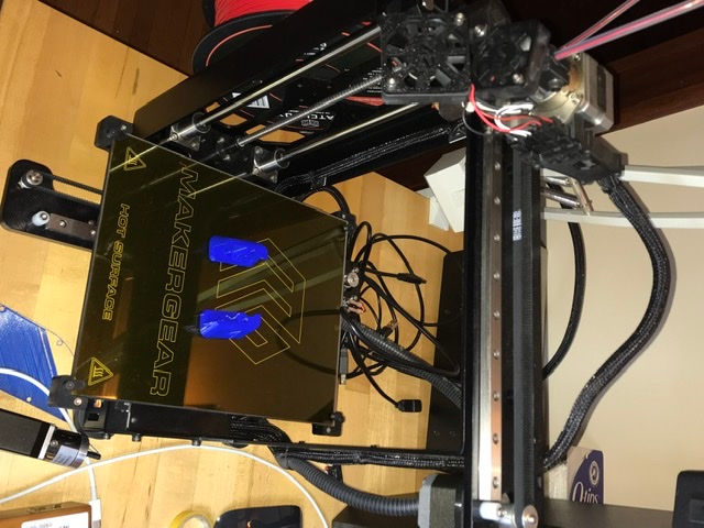

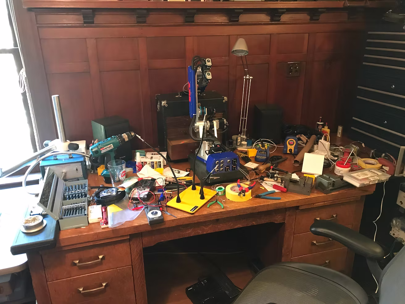

Nothing exhaustive but I’ll try to include useful stuff as well as general progress.
Most of the 3d printed parts ... not sure I like the colors but it was the least offensive of the filament I had sitting around

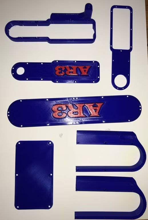

Robot mechanical all complete, control box, and cables built. Next step firing it up. I’ll spend a bunch of time checking things ... hopefully, movement in a few days.
looks good. Were shut down here too. Im one of a few people still in the shop but most of the city is working from home. Stay safe.

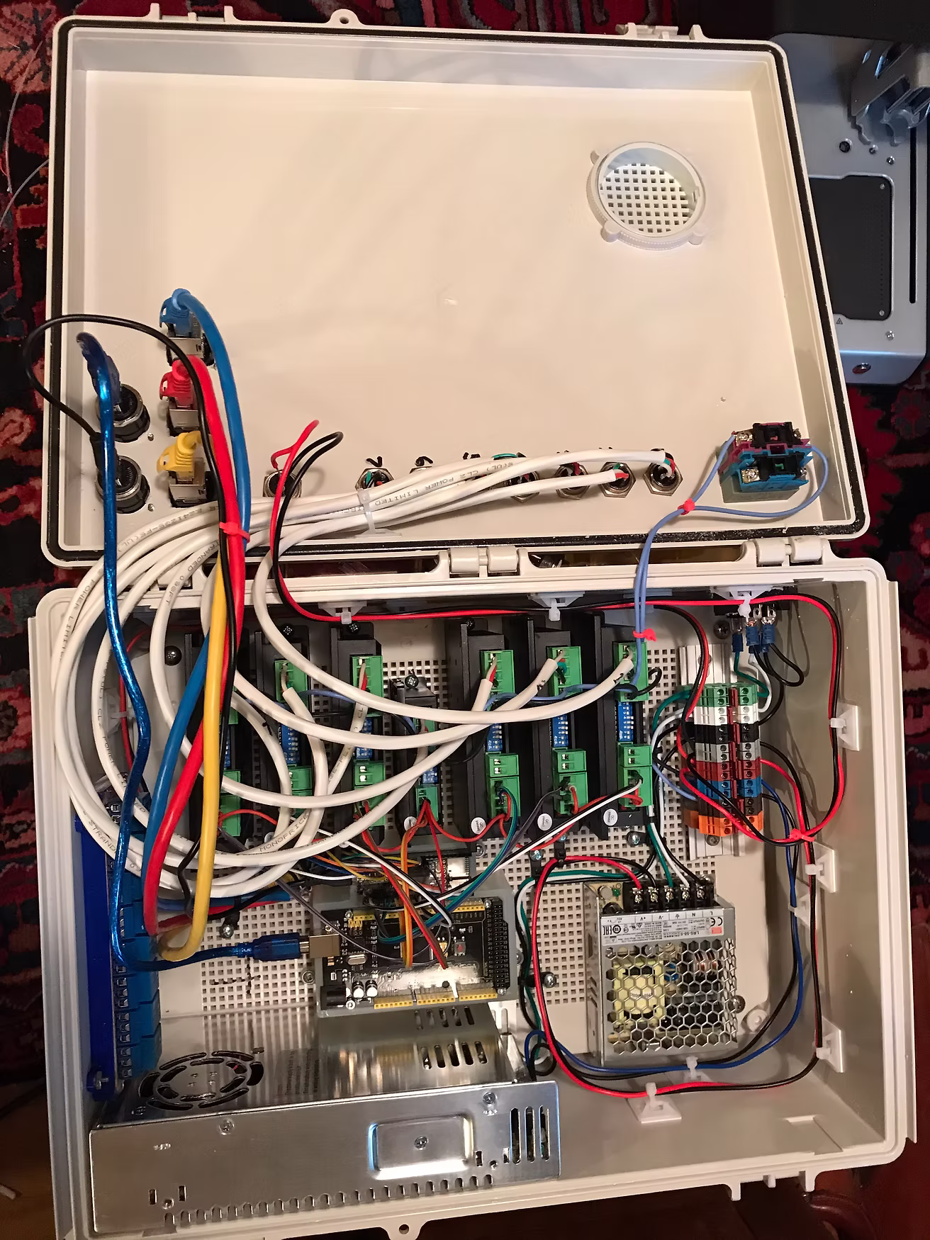

Stuck in the house because of Covid-19 (I don’t have it yet but Seattle is shut down). Basically done with the control box

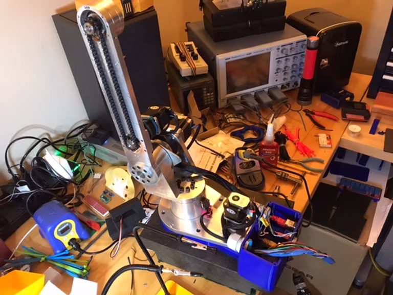

Working on the fifth axis
https://anninrobotics.com/wp-content/uploads/2025/07/Bobs-Build-Log-Seattle_5.avif

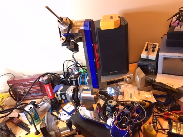

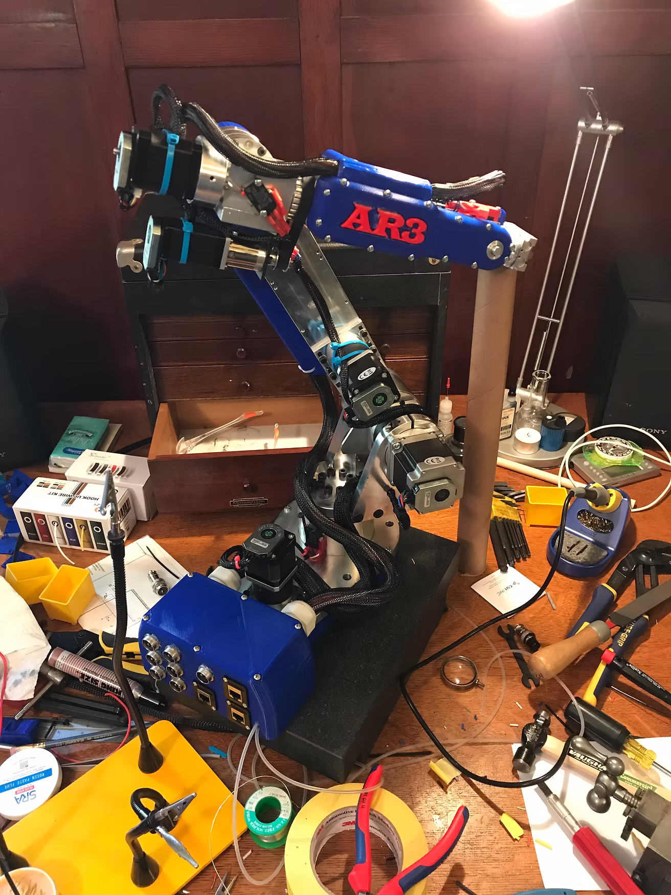

Current state of things:
https://anninrobotics.com/wp-content/uploads/2025/07/Bobs-Build-Log-Seattle_8.avif

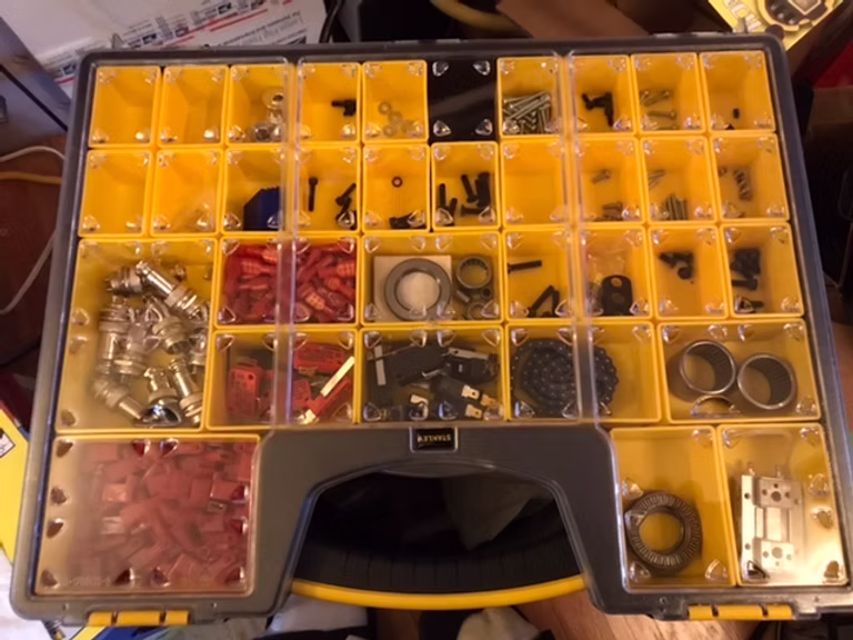

I found it very handy to store parts in an orderly way as I do the build. These cases are nice because the storage bins are removable boxes:

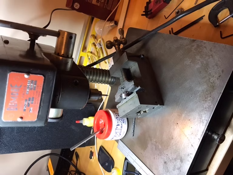

Using my sensitive drill press to drill the set screws:

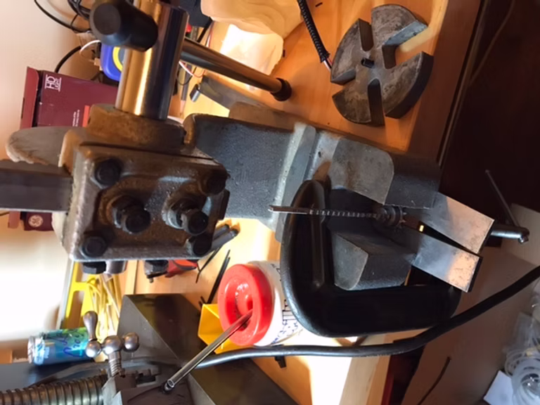

I broached all of the gears with a little setup. The arbor press was too small so I had to improvise with some steel rods and a C-clamp:

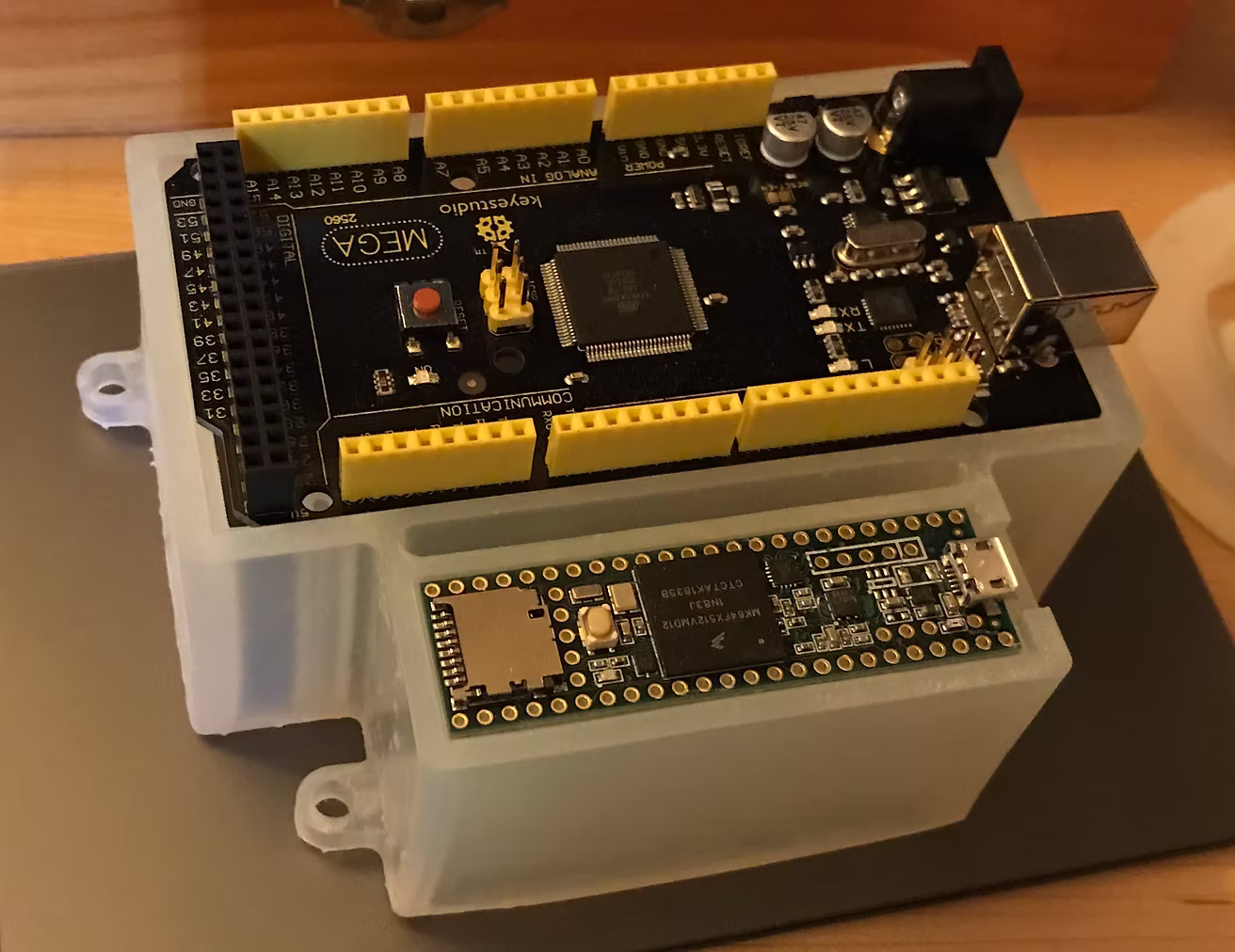

I started printing things on a Formlabs Form 3 but it’s work volume is too small for the bigger pieces and it is kind of overkill. I did print a few things, such as the controller mounting box:
