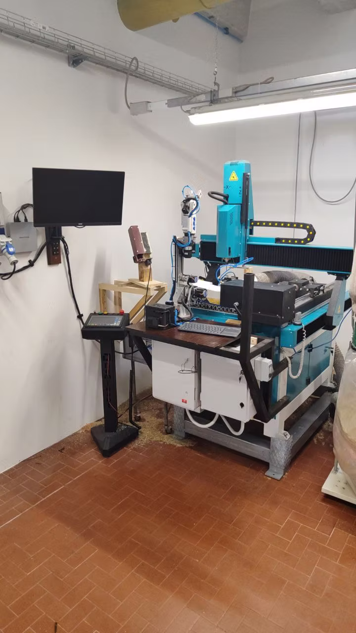

I've finished building two new machines and I'm excited to share the results with you.
Both machines are designed to automate part replacement.
The first one is a 4-axis CNC milling machine. We produce two types of identical products, and I've created two cassettes for them.
https://anninrobotics.com/wp-content/uploads/2025/07/Finished-progect-AR4-in-Italy.avif
A robot picks up a part from the cassette, places it on the machine, clamps it down, and starts the program. Once the program is finished, the machine's portal moves back, triggering a mechanical limit switch that signals the robot to start the next cycle. There's a limit switch in the cassette that stops the program if it's empty.
One cycle takes 15 minutes (meaning the robot needs to work every 15 minutes). This machine has been running for 3 months and has completed over 1000 cycles.
