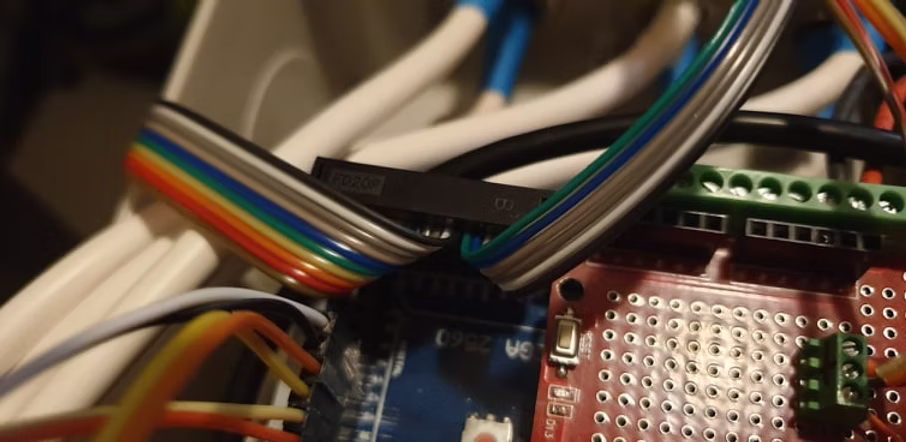

And here is what you need in order to make the magic happen.
A module with two analog Joysticks, cable 1 mm thick and self - taping socked.
The socked with the cable you mount on Arduino Mega board. Then u can check with a multimeter which of the pins corresponds to signal of the cable. You will see this below in the program as an example in my case, but you can setup a different way for you.
https://anninrobotics.com/wp-content/uploads/2025/07/AR2-control-with-a-joystick.avif
https://anninrobotics.com/wp-content/uploads/2025/07/AR2-control-with-a-joystick_2.avif
https://anninrobotics.com/wp-content/uploads/2025/07/AR2-control-with-a-joystick_3.avif
