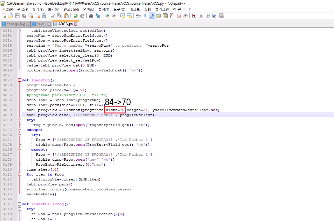

I think because screen resolution issue cause alignment changed, u can edit ACSR.py and change line ~6233: ProgEntryField = Entry(tab1,width=<change to suitable width avoid box cover the button>)

@userpie
1. If I adjust 84 -> 70 on my PC
- Screen OK
- However, the USB port (MEGA2560, Teensy3.5) is not recognized.
2. What's the problem? Please advise.
3. The monitor must not be adjusted.

just check device manager get your com port number, or use arduino ide check your com port no, and set in the program
