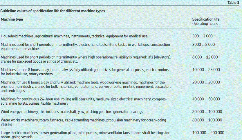

On page 88, Table 1, you find that the design and operational environment have an effect on the order of magnitude 3 or 4. With low quality bearings, you will be in the top of the table, and with low load on the robot arm, you will be in the bottom of the table.
Page 88, Table 1 (SKF 2018):
