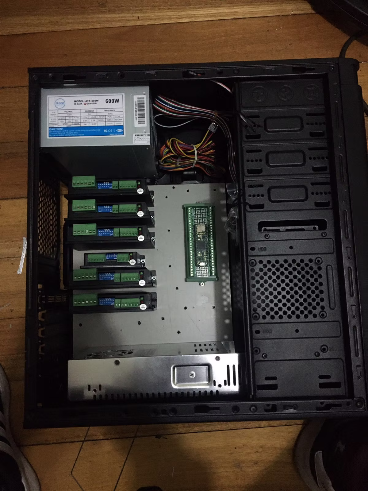

Hey Chris! @Chris Annin
I have an a lower cost enclosure option using a generic pc tower, here its de CAD Files and what I do
Using this tower that I bought for 18$
https://anninrobotics.com/wp-content/uploads/2025/08/Enclosure-Options-.avif
I made this CAD file using the mounting holes for the processor
https://anninrobotics.com/wp-content/uploads/2025/08/Enclosure-Options-_2.avif
If u need the CAD file please comment, I cant upload as a comment
So using aluminium composite panel for the base:
https://anninrobotics.com/wp-content/uploads/2025/08/Enclosure-Options-_3.avif
And here it is the final result:
Im using two PSU, the PC one its for the external IO devices.
Greetings from Ecuador!
@mateo-josue-cruz-gallegos Nice, that's a really good solution. Thank you for sharing the pictures.

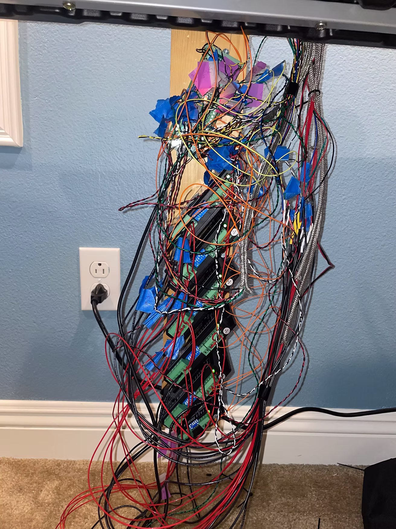

sorry guys the lowest cost is no enclosure for me😂
https://anninrobotics.com/wp-content/uploads/2025/08/Enclosure-Options-_6.avif
