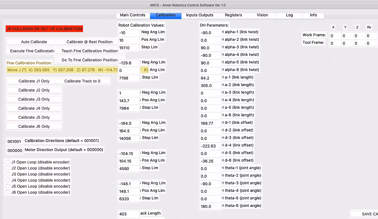

How you start the client application? I tried using ARCS source file 'ARCS.py' it give me blank screen as below
You have any ideal why it look like this?

Problem solved:
I use ARCS source file,
1. comment line ARCS.py line 67,
root.wm_title("ARCS - Annin Robotics Control Software Ver 1.0")
#root.iconbitmap(r'AR.ico') //Linux and Mac can't find this icon
root.resizable(width=True, height=True)
In
2. install required package in python
pip3 install numpy serial //or use full path
2. Use arduino ide to identified both serial port of teensy and arduino, in my case:
/dev/tty.usbmodem79744201   # teensy
/dev/tty.usbserial-14330   # arduino
* u may get /dev/cu....., it is same
3. Copy both serial port into COM port column, press button 'Set Com'. You should able to connect it.
** I have ugly GUI, most probably retina display cause it and I cant solve it.

Yeah. I have same "ugly" interface. There are couple of reasons. Tkinter renders fonts on Win and Mac differently so majority of labels are out of boundaries. Also transparency mode is different in mac so you can see white background for labels. There are also some differences around text box widths based on number of characters. Anyway it works and can control robot and that is the main thing 🙂

Eventhought ACSR.py is running fine, but it is annoying cause cannot see the label properly, I fixed the x position of label as below method.
