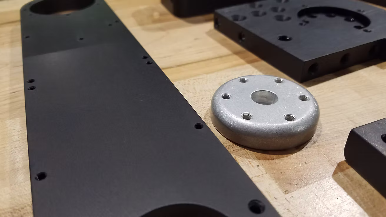

Parts came back from plating today
https://anninrobotics.com/wp-content/uploads/2025/07/Ar3-build-southern-california.avif
They came out exactly how i wanted, matte black, well worth the $70
https://anninrobotics.com/wp-content/uploads/2025/07/Ar3-build-southern-california_2.avif
The J6 bearing cap was hiding in the tumbler and escaped plating, it will have to wait for the batch of parts being machined to go out

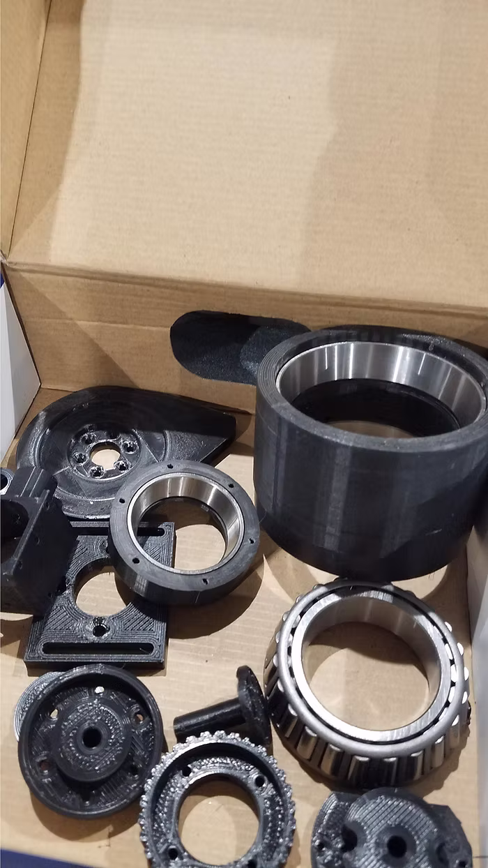

https://anninrobotics.com/wp-content/uploads/2025/07/Ar3-build-southern-california_3.avif
now to get the races out of the printed parts

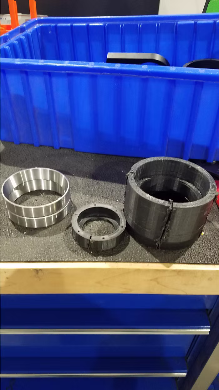

https://anninrobotics.com/wp-content/uploads/2025/07/Ar3-build-southern-california_4.avif
little bummed they had to be destroyed to get the races out, body saw made quick work out of the plastic.
all my bearings ended up a slip fit, i put a little red loctite on them to retain them.

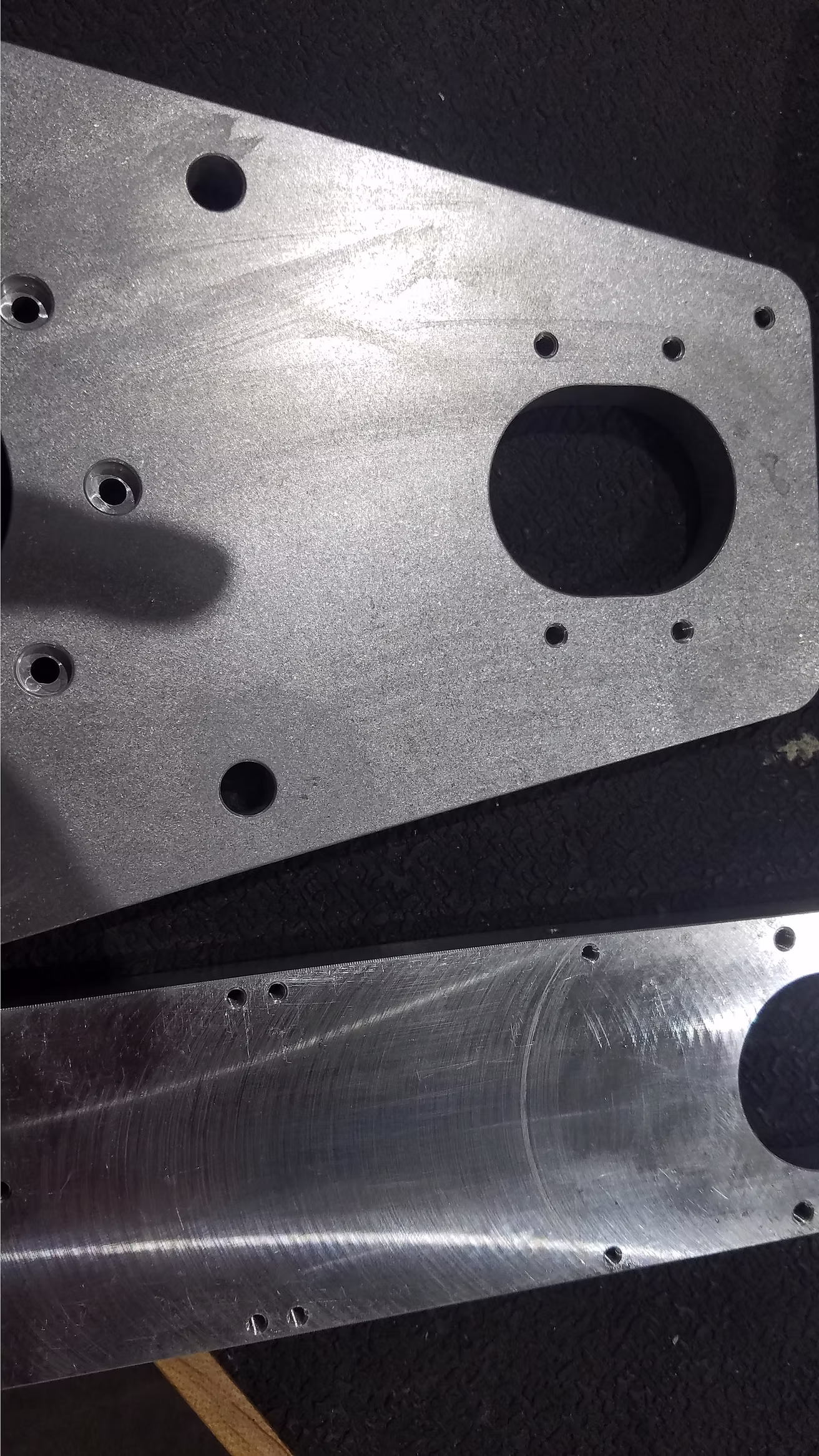

So i stayed late tuesday night and go all the parts deburred and tumbled
https://anninrobotics.com/wp-content/uploads/2025/07/Ar3-build-southern-california_5.avif
The tumbling evens out the machining marks,breaks all the edges,and gives the parts a more industrial appearance. They should be back from annodizing tomorrow

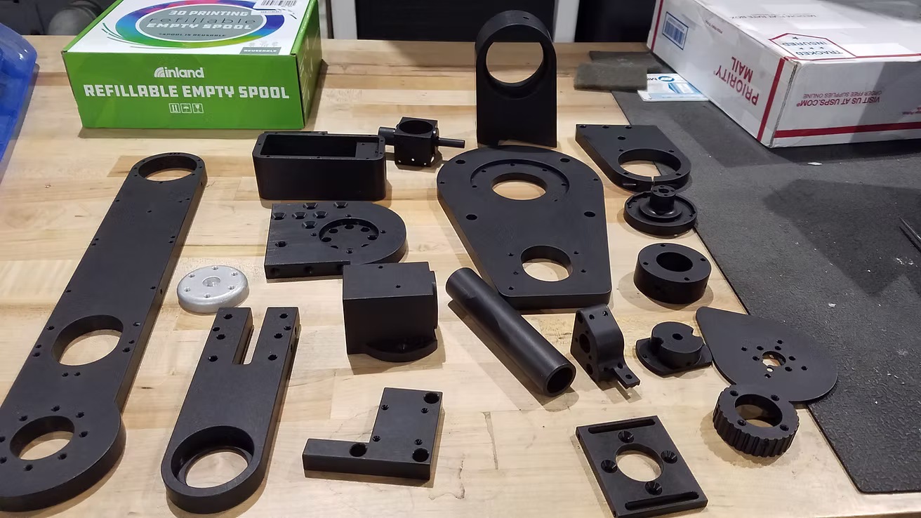

https://anninrobotics.com/wp-content/uploads/2025/07/Ar3-build-southern-california_6.avif
I did decide to hold back the J1 and J2 spindles, as well as as the small j5 parts. since they arent visible when assembled.
Looks like im building a robot this weekend
