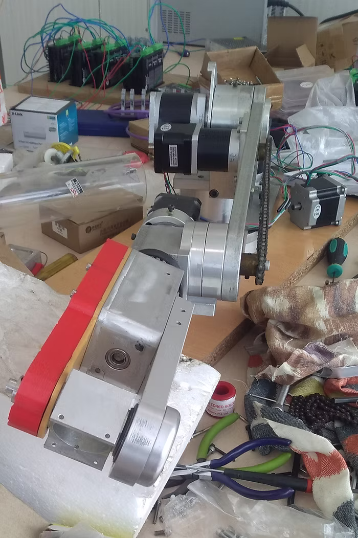

Thank you. Its a highly valuable suggestion. I will incorporate it. There is a problem with my J2 motor. I cannot able to remove the screws in the gearbox. I applied WD-40 and diesel. But I cannot able to remove it. Any suggestions please
Looks good so far, your J3 chain looks a little far away from the arm, you may want to reverse the sprockets so that the chain is close to the J2 arm. thanks for posting and let me know if you have any questions.
