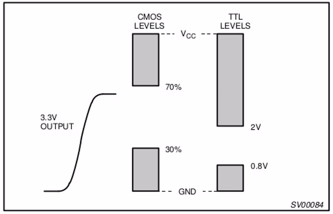

3.3V ouput works well with 5V TTL logic but won't with CMOS.
The question is which driver use which logic.
My CNC use DQ542ma's driven directly by outputs of a cortex M3 (LPC1768) which is 3.3V. Wires needs to be short and the wiring is different: you provide common GND and the controller provide VCC to EN, DIR and STEP.
