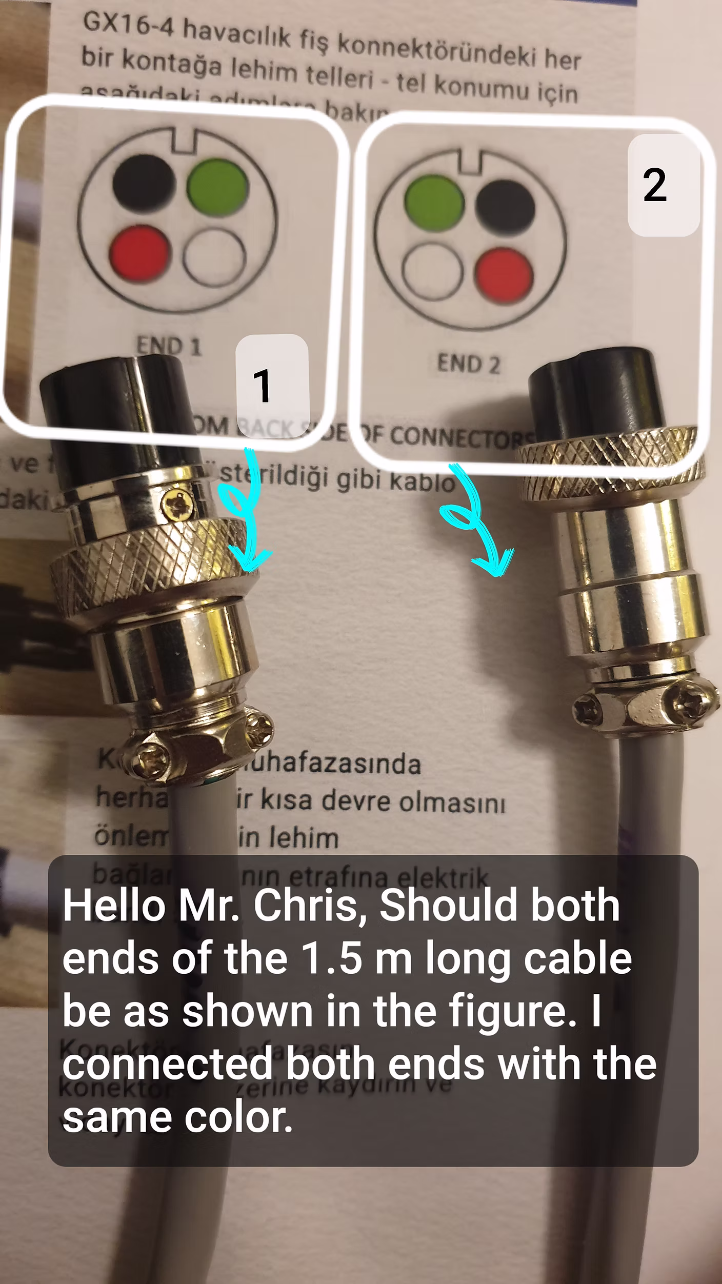

@chrisanninI made both ends of the cable as in the figure.
They should be wired "straight through" - each end of the cable will be mirrored, meaning that looking at the soldered side of the connector going clockwise starting at the notch - on end #1 (https://anninrobotics.com/search/posts?query=%23#1) should be green white red black. And then on end 2 should be black red white green. The ends should not be the same.
ttrobotics
@Chris (https://anninrobotics.com/community/questions/cable-connection) Annin that is, both ends of the cable consist of the same colors. I'm talking about 1.5 meters of cable. Colors on one end of the End 1 cable and End2 on the other end of the cable? Or did you mean to explain the soldered and numbered parts?
