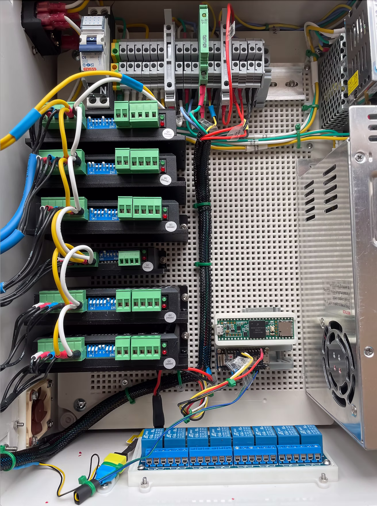

I have recently completed the assembly of the AR3 mechanics and am completing the electrical panel these days.

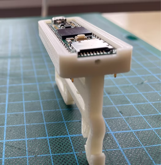

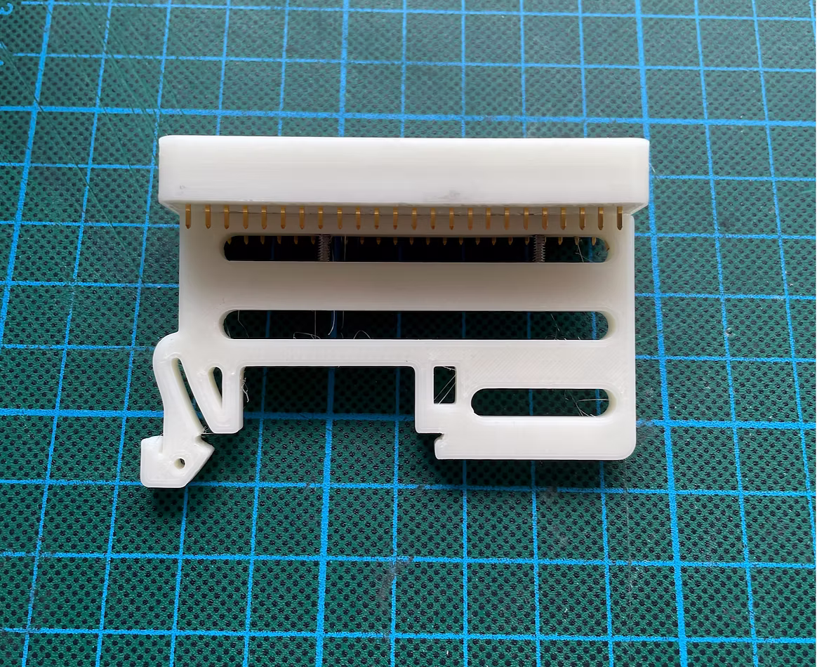

I also belong to the group of supporters of DIN cradles, so I designed one for the Teensy. The cradle and the din mount are mechanically coupled with (2) M2x8 screws, once inserted the board stays perfectly in place, but I have however placed a hole for an M2x3 set screw on the short side of the board at the height of the centre of the SD card slot.
I have attached stl files of the two components here in case they might be useful to the rest of the community.
The model is sized taking into account Z-Ultrat shrinkage, layer 0.19, infill 10%

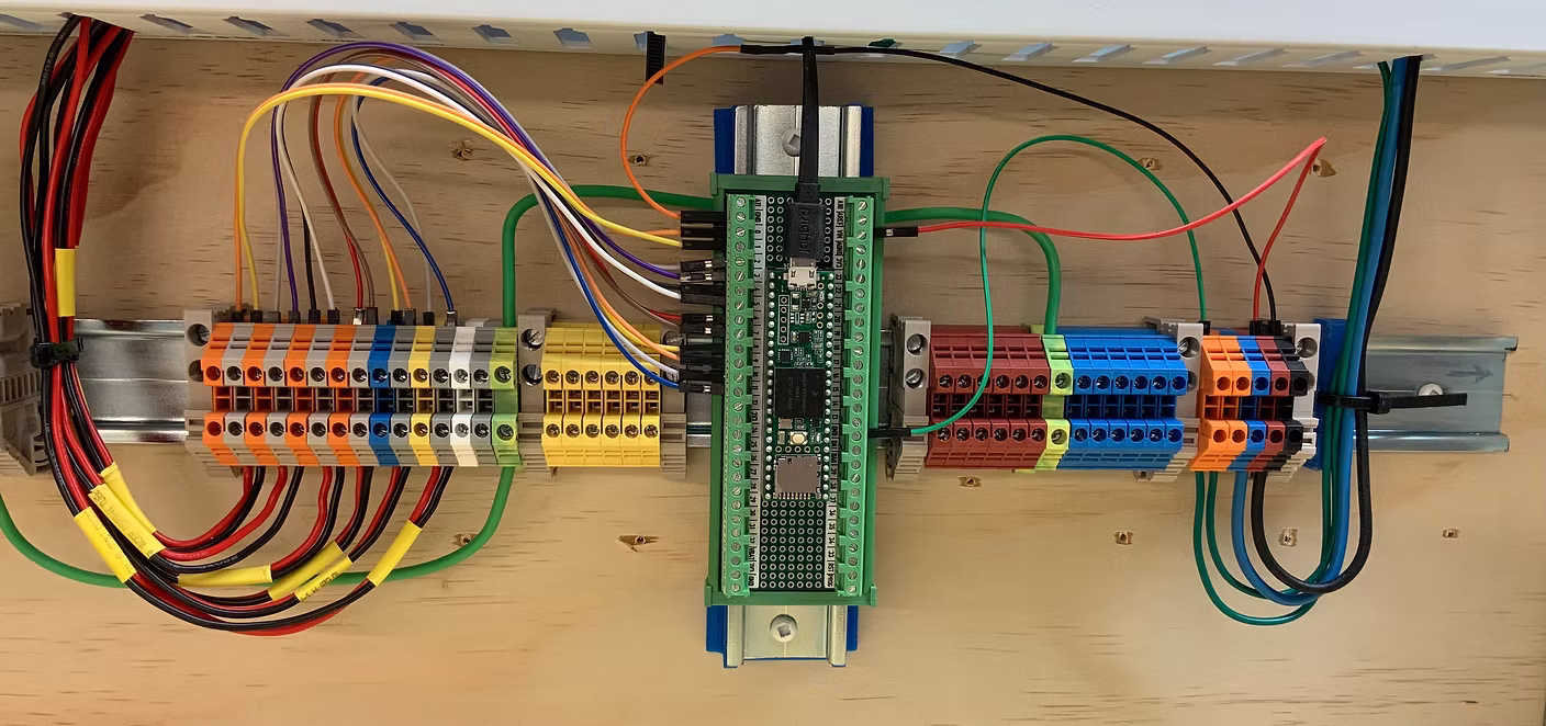

Thats cool, wish they had that available when I put the manual together... I may need to add a note to the manual that this is an option. How does this breakout board work for boards without pins soldered in?
