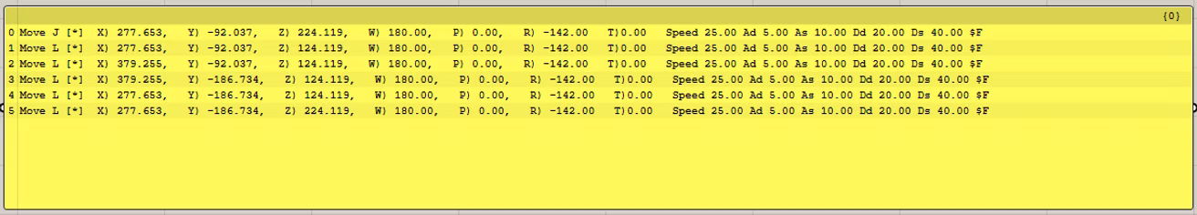

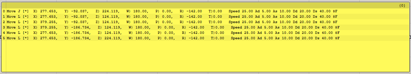

Hi Chris, Firstly thank you so much for this wonderful pathway to robotics and amazing documentation. I was wondering on the same context of the question if you were able to explore the possibility of reading an external program in your ARC software. I have a code writing in an external software which I would like to upload it on to the ARC software. Please let me know if that is possible.
Hello, I will be working on a gcode interpreter but I dont have that up and running yet. Let me know if that answers your question or if you have a specific format need.
Pradeep Devadass
Many thanks for your response, Chris. Maybe I might sound stupid, But I assumed regarding g-code it just has a position and a normal (mainly used for milling or point tools), Will I be able to exploit the XYZWPR of the Robot's 6DOF in a gcode? I was able to create a code generator in grasshopper for Joint and Linear movements in Grasshopper and was also able to export into a file.
But as soon as I using ARC interface and load the program. Everything seems to be deleted. So was wondering if there is a way to upload the generated program directly into your ARC interface either by using load program or something. Please let me know. Thanks.
what is the file type being exported, The programs in my software are a python tkinter list.
Pradeep Devadass
I just exported a file from grasshopper with a similar code. Is there a specific tkinter list format? If possible, please can you share a link where I could learn from?
