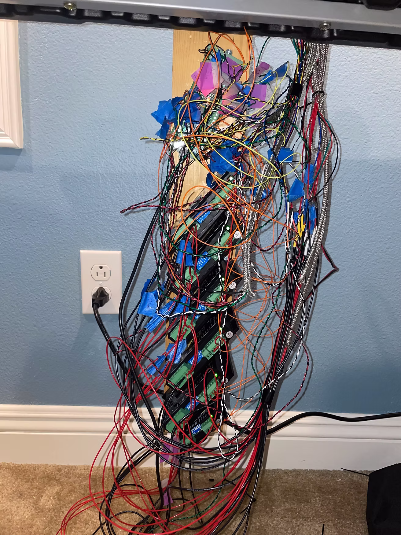

I’m using an old pc tower for mine

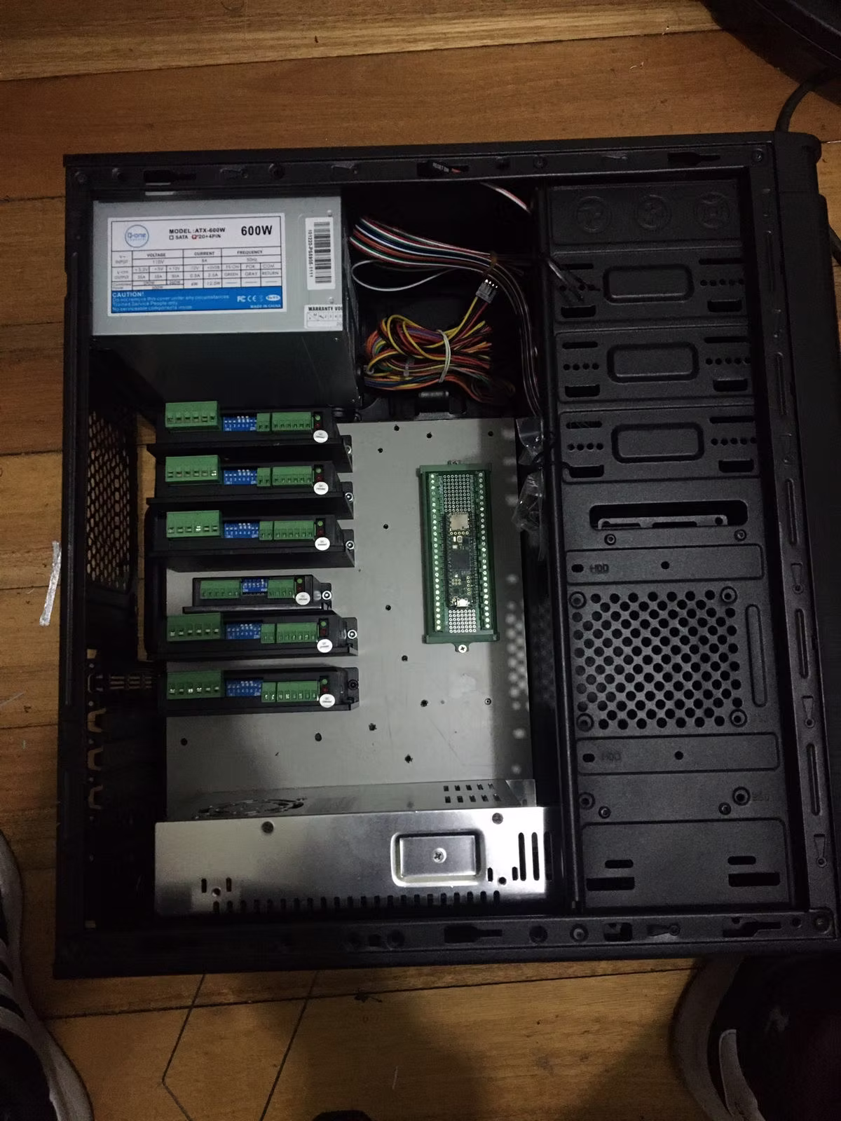

I have an a lower cost enclosure option using a generic pc tower, here its de CAD Files and what I do
Using this tower that I bought for 18$
I made this CAD file using the mounting holes for the processor
If u need the CAD file please comment, I cant upload as a comment
So using aluminium composite panel for the base:
And here it is the final result:
Im using two PSU, the PC one its for the external IO devices.
Greetings from Ecuador!
Nice, that's a really good solution. Thank you for sharing the pictures.

sorry guys the lowest cost is no enclosure for me😂
