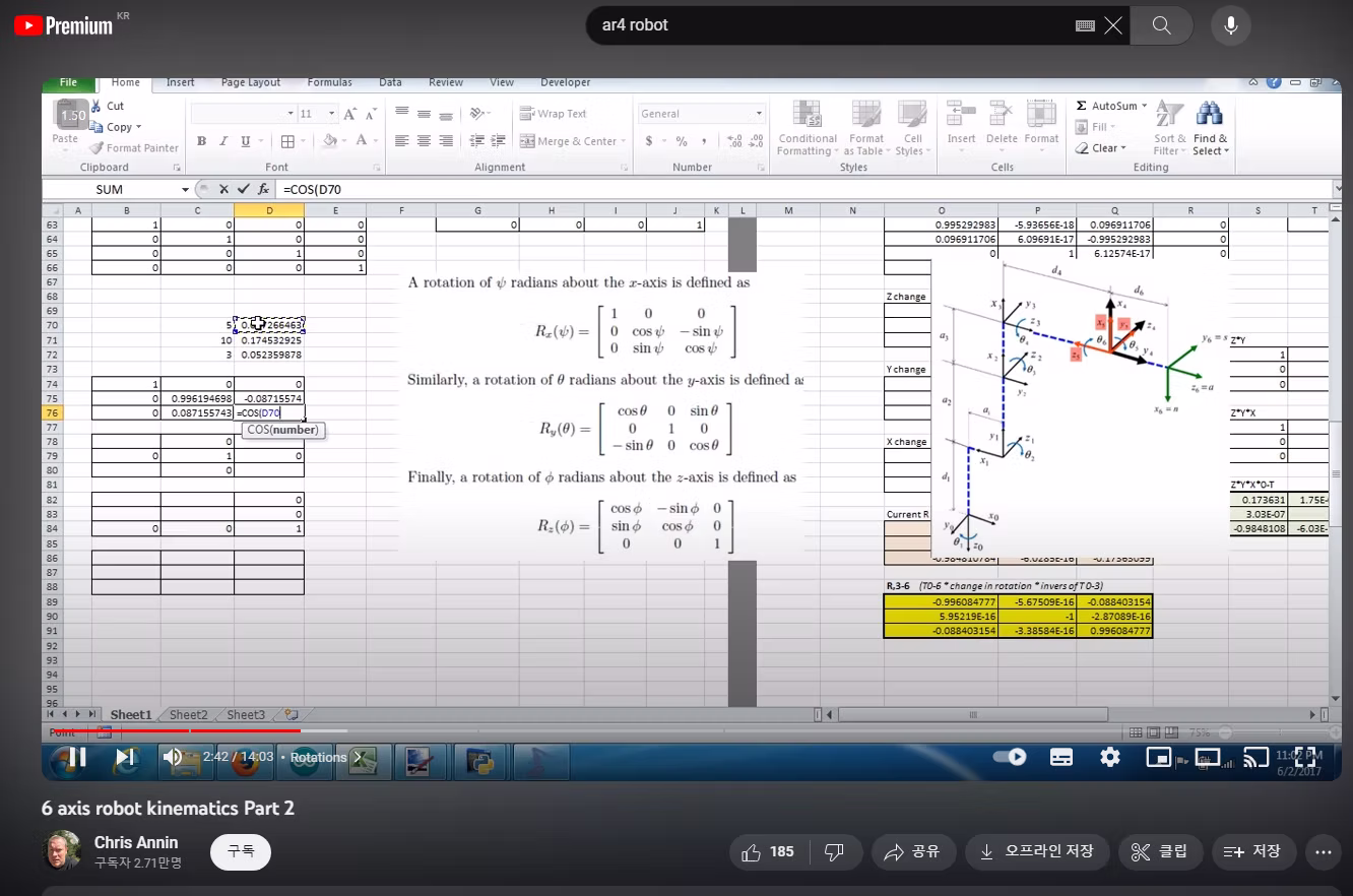

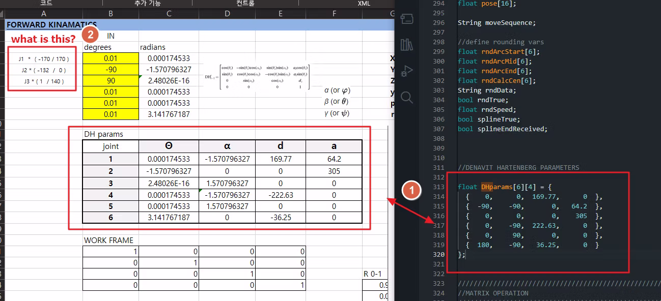

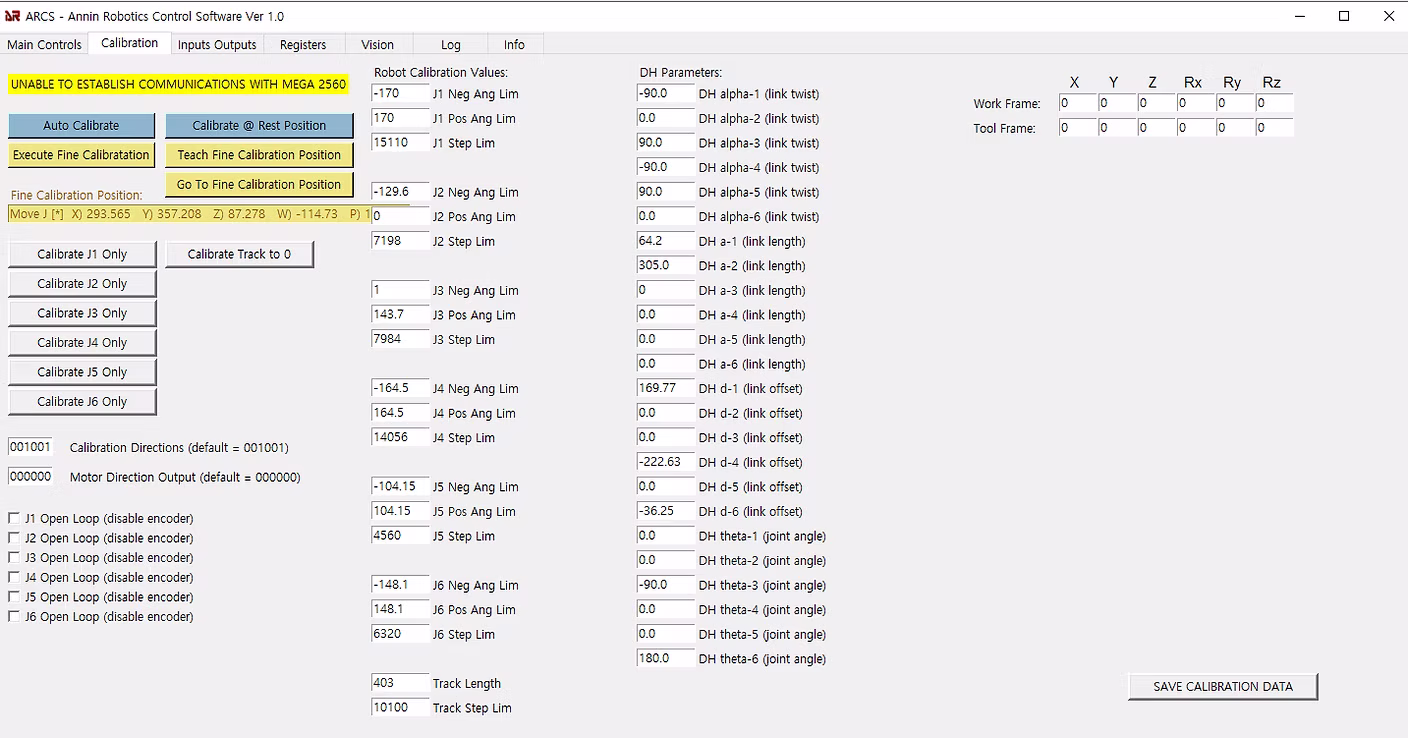

I want to know dh parameter
hello. Everyone, I am a student who has assembled AR4 for the first time.
I wanted to know how ar4 works, so I studied Annin's YouTube channel.
I found out that the dh parameters of ar4, ar3, and ar2 are different.
Can you tell me why the link length items for ar3 and ar4 are slightly different?
