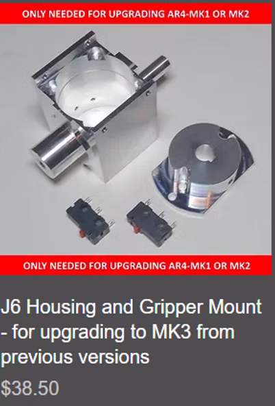

Hey Team,
What exactly has changed CAD wise for the new MK3 J6 gripper parts (see pic)?
Is it just the mounting holes for the new limit switches? Can they be easily drilled/tapped on the old MK1/2 components?
Cheers,
Johann
The housing bore is a 5mm larger and the depth also changed, its 10mm taller. Unfortunately its not as easy as adding the tapped holes. I had hoped to avoid changing the parts on everyone but there was no way to updated to the better gearbox without doing so.
Thanks for the reply, no worries 🙂
