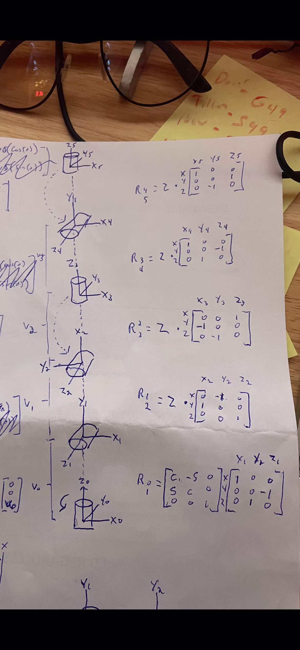

I was wondering if you had a kinematics diagram for the AR. I see in the manual that you have some dimensions but I would like to see the distances between the center of every joint J1 ----> J2 ---> J3 ---> J4 ---> J5 ---> j6.

Yup! That is what i was looking for. My kinimatics diagram i based my simulator on is slightly different than yours i think ( see attached image ) but i think i can use these numbers as my v0 - v4 variables. Thanks !
