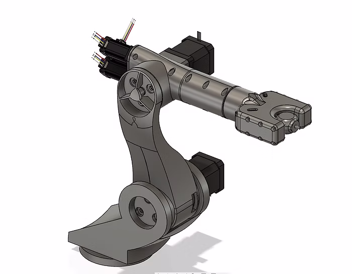

I am designing a robot from scratch with a differential wrist similar to the one on this video :
I would like to modify the program of the AR4 for the teensy 4.1 to fit these new kinematics, but I'm not that good at programming.

Here's a pic of my work in progress :
Any comment or help is welcome ! many thanks !
