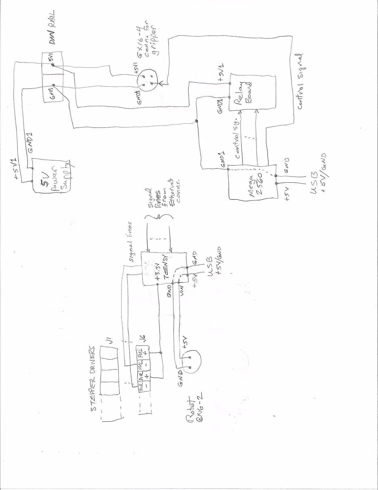

Thanks, Chris. I just want to list the specific statements that I sent to you in an email and you confirmed, along with a hand drawn schematic (see below). This may break it down even more so.
1. Both microprocessors (Teensy and Mega) are being powered by the +5V from their respective USB ports. This is labelled +5V/GND.
2. The Teensy +5V powers the GX16-2, which powers all the robot’s encoders and limit switches. The GX16-2 actually connects to the Teensy's Vin pin, but in the Teensy schematic, internally, Vin is connected to the USB's 5V. Additionally, the Teensy's +3.3V output powers the stepper motor drivers’ PUL+ and DIR+ inputs.
3. The Mega’s USB port also provides +5V/GND, but it just powers the Mega board.
4. The 5V power supply provides separate power, labelled +5V1 and GND1. This gets connected to the DIN rail, and powers the relay board. Since I am using a servo gripper instead of a pneumatic one, I will also run this +5V1/GND1 power to a GX16-4 connector dedicated to the gripper.
5. GND1 also gets connected to the Mega board ground, which internally connects it to the GND ground from the USB port.
One Question: earlier in this post (e.g., D.D., March 18) the question was raised about whether 3.3V was adequate for inputs to the stepper drivers. Given that the Teensy's 3.3V is derived from the USB's 5V input, and this 5V appears at the Vin pin, could we power the stepper driver inputs from Vin instead of the 3.3V pin, and better meet the specs of the drivers?
