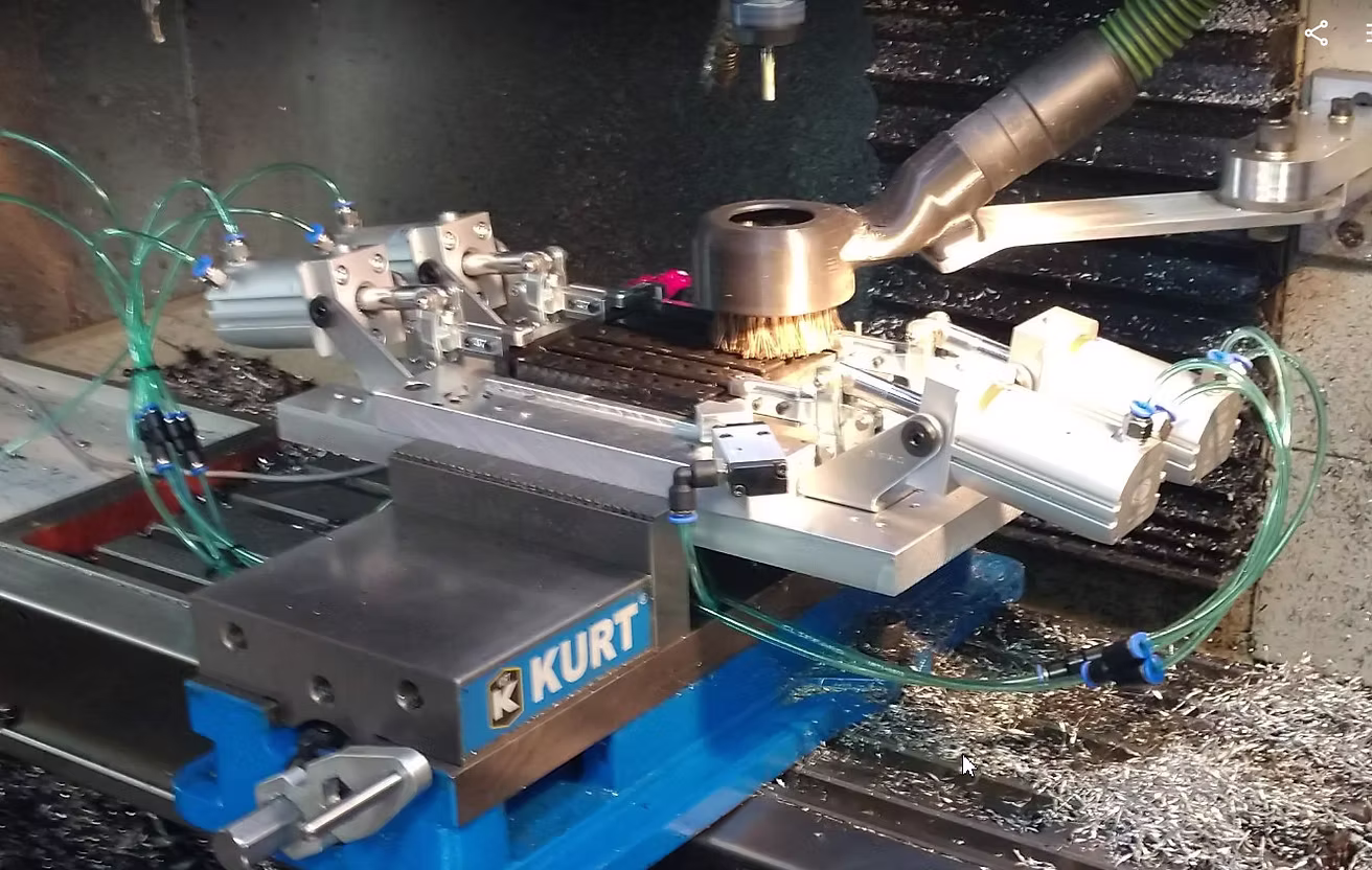

Buddy, I don't think that can be done as the software is now. I have my robot setup to change stock/parts in and out of my vertical milling machine. I have many inputs setup, but I use them as safety checks, like sensors to make sure a piece of stock is actually in the gripper before closing. Another example is checking to be sure the mill door is open before the robot makes a move inside. Yet one more example is that I have a sensor verify that the new stock is in place before the vise fixture clamps.
