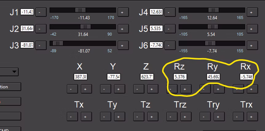

Rz Ry Rx calculation in AR4 software
Hello, Using the latest software AR4, how to calculate yaw pitch and roll circled in yellow? any pointer is greatly appreciated
David T. Phan
ZYZ is used in AR4 software to calculate Rz,Ry and Rx. It DOES NOT appear to be ZYX but I could be wrong. Calculation for ZYZ Euler angles can vary depend where you get your source which is mostly on google. Can be frustrating when one is trying to learn.
