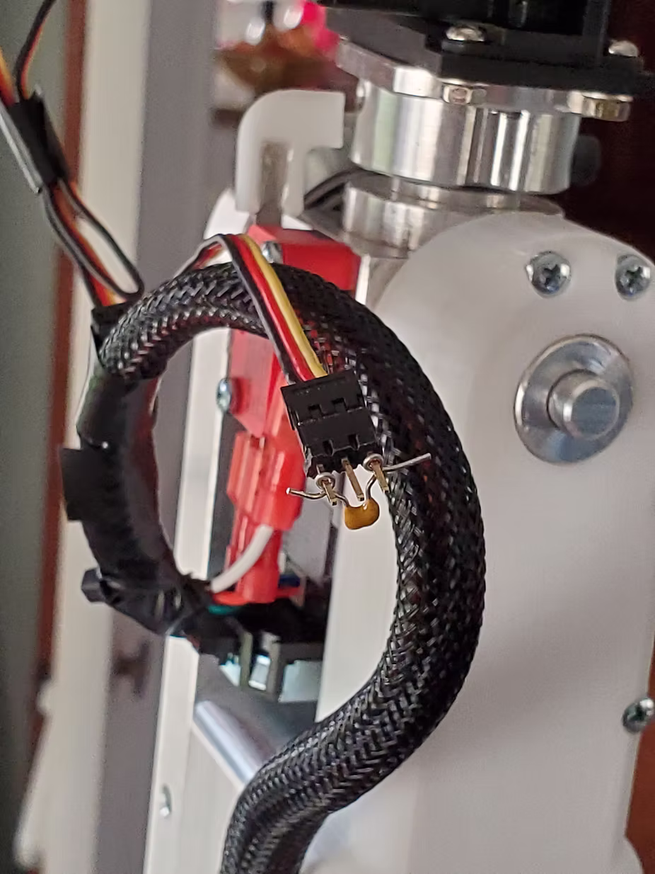

Anyway, this almost did the job. With the 24V power on, I was able to completely control the gripper. However, there were occasional gripper twitches, so I wasn't finished. I hooked an Oscope up to the servo wires (signal on the yellow wire and ground on the black) and saw the problem: With the 24V power off there was a clean pulse at 200KHz (the servo control), but with the 24V on there was a strong 1MHz pulse on the frequency display and some jitter. But I noticed that there was no physical twitching of the servo when the scope probe was attached. I figured that the capacitative loading from the probe (approximately 100pF) attenuated the noise enough to eliminate the twitches. I removed the scope probe and attached a 471pF capacitor between the yellow and black wires at the connector to the servo (see photo below) and this did the job -- full control of the gripper and no twitching.
